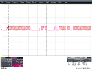

  • Tried to implement the trip zone and causing a trip with EPwm1Regs.TZFRC.bit.OST = 1.
    However, this is causing random switching after pressing the start switch (shown below). I am placing the trip first thing before setting the PWM parameters, then clearing within an ISR when pressing a start switch, and trip again when pressing the switch to stop, also within the ISR. (Yellow - PWM1A, Violet - PWM1B). At the moment I am switching with 50% duty cycle.
    I have also noticed that every time I start the PWM running I am having PWM1B high for 2us, before starting switching at the duty cycle. (Shown in the diagram below).

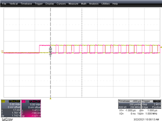

  • I have managed to remove the 200us from the first start after power on (diagram 1), however I am still getting a high period on 1B output at consecutive start-ups of the converter (diagram 2). This high period varies up to 200us. I noticed that this is happening only when I have dead band applied and using only 1A to issue bith 1A and 1B. This does not happen if 1A and 1B are inverse of each other but independent without dead band.
    Note: I changed the duty cycle to 0.7.
    Start ISR code:
        EPwm1Regs.AQCSFRC.all = 0x0000;     // Action-qualifier continuous s/w force register
        asm("  IACK  #0x0001");                // IACK - CLA task 1 force instruction
        asm("  RPT #3 || NOP");                // Wait at least 4 cycles
        while(Cla1Regs.MIRUN.bit.INT1 == 1);   // Loop until task completes
        EPwm2Regs.TBCTL.bit.CTRMODE = 0x0;  // Enable the timer in count up mode
        EPwm1Regs.TBCTL.bit.CTRMODE = 0x0;  // Enable the timer in count up mode
        if (EPwm1Regs.TZFLG.bit.OST == 1)
           asm(" EALLOW");
           EPwm1Regs.TZCLR.bit.OST = 1;
           EPwm1Regs.TZOSTCLR.all = 1;
           asm(" EDIS");
    Stop ISR code:
        asm(" EALLOW");
        EPwm1Regs.TZFRC.bit.OST = 1;       // Force Trip PWM1 - force low on output
        asm(" EDIS");
        EPwm1Regs.AQCSFRC.all = 0x0005;     // Force continuous low on output - Action-qualifier continuous s/w force register
        EPwm2Regs.TBCTL.bit.CTRMODE = 0x3;  // Disable the timer
        EPwm1Regs.CMPA.bit.CMPA = 0;    // Set duty cycle to 0 to start again
        //EPwm1Regs.CMPB.bit.CMPB = 0;    // Set duty cycle to 0 to start again
        asm(" EALLOW");
        //--- Force Task 8 to clear to zero the controller and duty cycle
            Cla1Regs.MIER.all = 0x0081;            // Enable CLA interrupt 8
            asm("  IACK  #0x0080");                // IACK - CLA task force instruction
            while(Cla1Regs.MIRUN.bit.INT8 == 1);   // Loop until task completes
        //--- Enable CLA Task 1 interrupt and disable Task 8 interrupt
            Cla1Regs.MIER.all = 0x0001;        // Enable CLA interrupt 1 (and disable interrupt 8)
        asm(" EDIS");                      // Disable EALLOW protected register access
