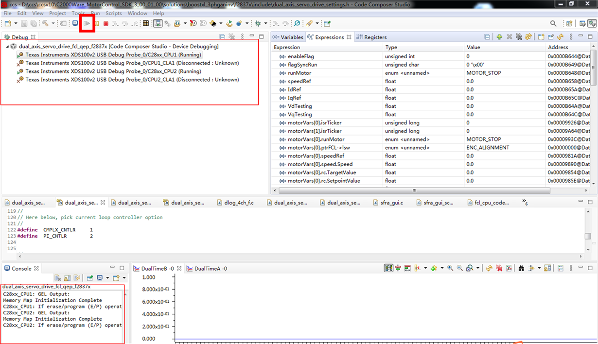

I now debug the LAUNCHPAD 28379d,It can download the program, But the button RUN is always gray, can't run.
just like below.What's wrong ?

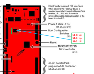

    What is the boot switch setting? You may want to set it in Wait-boot, and then try.

    I don't know how to setup the boot switch setting in ccs.from the picture we can see, this is the GUI when I selected the debug button, it point out that I can't halt the program execution but only can terminate the executin. just like picture below.
    but as I have selected the cpu1 ,It can halt can also can run. but when I selected the cpu2 and also selected the halt button, it indicated  "trouble removing breakpoint with the action "finish auto run"..........."
    I have also tried the simple example as you indicated to, It worked well. so what's wrong? How to setup?

    Please refer to the user's guide of Launchpad.
    www.ti.com/.../sprui77
  • Hi Santosh ,
    Thanks so much for your reply.
    But as the file SPRACO3 indicated that all the S1 switch in the LAUNCHXL-F28379D need to up and I just did like that.

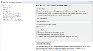

    So it's not the problem.It seems like that when I debug the second time ,It cannot start at the program of main();

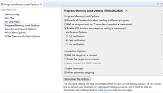

    But my debug options setup are like that , it seems right.
    I assume you have tried simpler example (blinky_led) from C2000ware driverlib , and it works, right? I just wanted to make sure your setup is correct.
    Then In Autorun/Launch option, uncheck "On a program load and restart". Then it will stop at "codestart" assembly code and then you can debug from there.

    Thank you for your reply,Now it works well.
