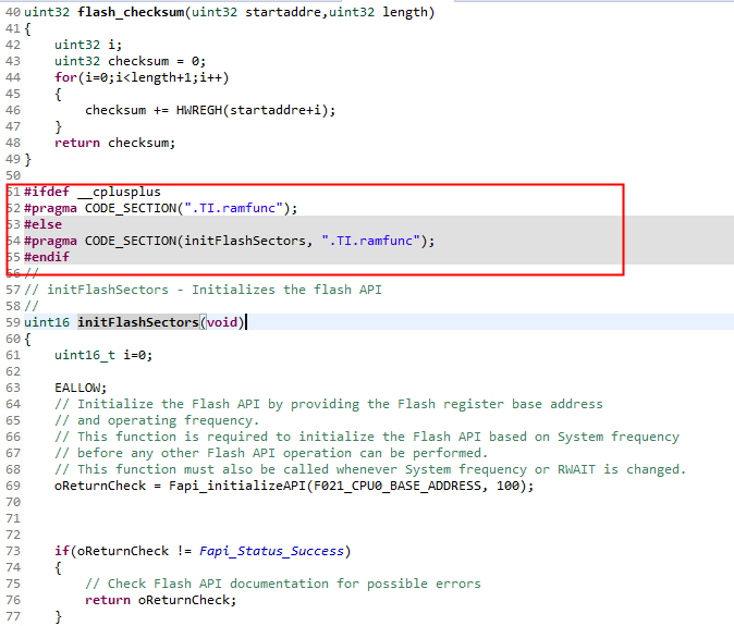

I add FLASH api library(F021_API_F28004x_FPU32.lib) in the pfc1ph3ilttpl_F28004x project, the device is TMS320F280049C, the whole project code( APP cde) is allocated in sector 1~ sector 5 of bank1, and will change the contents in sector15 of bank1 once the change condition meets. now, I found that, the APP code is run away when call the Fapi_setActiveFlashBank(), this function has not be returned. So, I need your help, tks!
see the details as bellow:
1.the FLASH api operation is referred to TI examples: first call the initFlashSectors(), then call FLASH_Erase(0x9000,0x1000), and last call FLASH_Program(0x9FFE8,8) to write data to the address 0x9FFE8.

3. initFlashSectors(), FLASH_Erase() and FLASH_Program() are all copy to RAM during running:
4. the out file map as bellow: the RAMM1 has full, does it affect the flash issue?

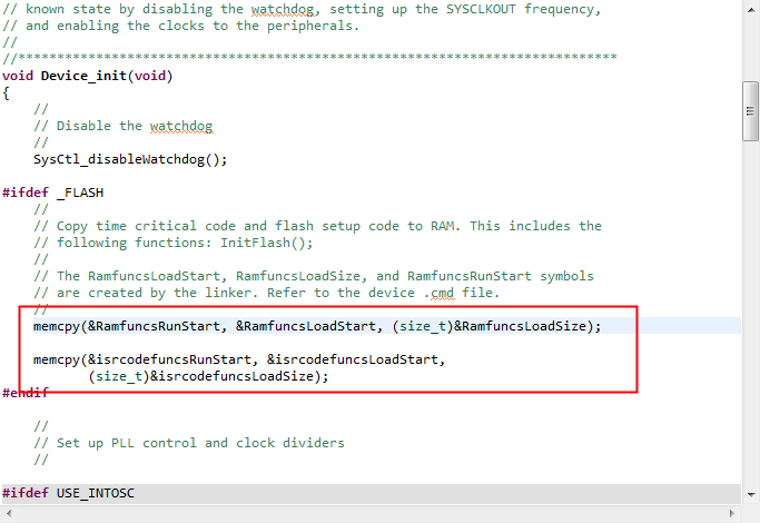

    If I understand correctly, your flash programming SW is loaded to sectors 1 to 5 and that SW updates the content in your sector 15.
    Where do you call memcpy()?
    In your linker cmd file, flash API is not mapped to run from RAM.  It is commented out - can you comment it, rebuild and then try?  Also, please make sure to call memcpy() before calling any of the flash operation functions.

    1.The memcpy() is called in Device_init(),as bellow:
