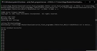

boot pins set to sci boot mode and flashed kernel but application is n ot loading after that nor flashing too not going successsfully.help me with process loading using cmd
  • Bhaskar,
    Are you using a F2833x controlCard, or custom hardware? Once the SCI Flash Kernel is downloaded, is there no prompt to download the application?
    Sira
    I am using f28335x custom hardware and its not no prompting to download the application.

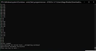

  • Since the Application Autobaud was successful, I would have expected the Host to begin downloading the Application to the target, with the Kernel running in RAM. Is the application file built correctly? i.e using the right options to convert the .out to .txt?
    hex2000 -boot -a -sci8 <.out filename> -o <output filename>
  • application was built using same command,(tried to flash serially using CMD using TX,RX of rs232 converter and pins boot pins set to SCI ).
