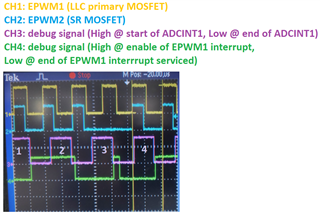

    Dom reply: I hope to illustrate that in the waveform below:
    (Note that the test code here forces the switching period to cycle between two different values every 4 ADC cycles)
    (EPWM1 interrupt is triggered at CMPA count up)
    CH1: EPWM1
    CH2: EPWM2
    CH3: signal representing ADCINT1 interrupt
    CH4: signal representing EPWM1 interrupt
    (The number/count posted on CH3 does not correspond to when the switching period is changed)
    The problem is that EPWM2 got a missing pulse.
    On other instances and other debugging iterations, I observed that the the PWM update problem presents itself as EPWM2.TBPRD not being updated along with other EPWM parameters, so the EPWM2 could be offset with respect to EPWM1, or EPWM2 would turn ON before EPWM1.
    So what I think happened here is that EPWM1 interrupt is still pending at the start of ADCINT1 #2.
    Since ADCINT1 has higher priority, it gets serviced first.
    But while ADCINT1 is being serviced, EPWM1 count up CMPA occurred, so EPWM1 interrupt gets in queue.
    so as soon as ADCINT1 is finished, EPWM1 interrupt gets serviced immediately.
    Unfortunately, that time frame lands near or at EPWM1 counter = ZERO, which is same as EPWM shadow-load setting,
    which I think causes a race condition between the software erase/write on the registers and the EPWM hardware.
    I have done other debugging, and I have always found a problem with EPWM updates when the EPWM1 interrupt lands near the shadow-load setting.
    So I thought that if I could clear the EPWM1 interrupt inside the ADCINT1, then maybe I could avoid the EPWM update problem.
    I want to clear the pending EPWM1 interrupt before I enable it again right after ADCINT1.
    Is it a good idea?

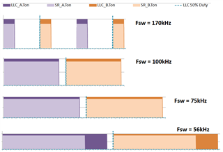

    From what I understand about the EPWM features and also based on the examples shown in the MCU's TRM, both features are unlikely to help produce our desired EPWM1 and EPWM2 waveforms (shown below); EPWM2 pulses are not always ON, as they are OFF at light loads.
    Given that the EPWM parameters are shadow-loaded, my iterations have led me to use my current EPWM settings in COUNT UP-DOWN mode, with independent values for CMPA and CMPB.
    Using other settings, I find difficulty in producing the falling edge relationship between EPWM1 and EPWM2.

    Given our desired EPWM waveforms and frequency range of 56-170kHz, I estimated that the ISR time need to be less than 8.65usec to avoid possible ADCINT1 and EPWM1_INT overlap.
    However, achieving that might be a bit of a stretch, at least in the immediate situation.
    For now, I can estimate a reduction of down to 11-12usec in the ISR time, which could still have a problem at Fsw ~ 61kHz.
