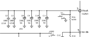

    What is your total output capacitance? The figures in the software user guide note that the output capacitance used was 2790uF, but the schematic shows less than half of that (C2+C3+C8+C9+C10+C11 = 1320uF). The output capacitance will have an impact on the transient response, so you might try adding a couple caps to get closer to the results in the user guide.

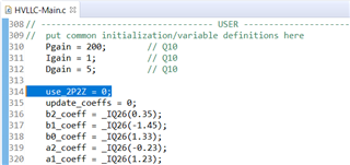

  • Hi Clayton,
    Thank you for your advice.
    In my environment, use_2p2z was 0, so when I changed it to 1, I succeeded in suppressing the voltage fluctuation to 426 mV by peek to peek as shown below.
    Voltage_Fluctuation_Slew_Rate.pdf
    Slew Rate of load current is 0.026A/us.
    And additional capacitors are used and total capacitance is 2790uF.
    But the settling time of output voltage after voltage fluctuation still takes around 1ms even though the TI's result takes only 208us.

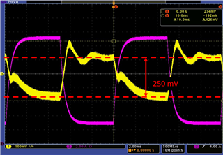

  • Hi U-SK,
    Thank you for attaching the scope shots. Two observations:
    1. That slew rate is very slow, are you using an electronic load with an adjustable slew rate?

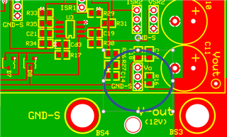

    2. It looks like there's about 250mV of regulation error between the 10% load and 60% load operating point. Where are you probing the voltage? Is it at the output of the power stage, or is it at the terminals of the load? This could be caused by cabling resistance if you're not measuring directly at the output of the power stage. Try probing the output voltage between the Vo and GND-S test points I've circled in the figure below.
    Please attach updated scope shots after you set the load for 1 A/uS slew rate and probe at the points I've indicated.

  • Hi Clayton,
    , I attached scope shots at the probe point you mentioned after configuring slew rate as below.
    Load_Fluctuation_Measurement.pdf

  • Your transient response doesn't look too far off in terms of overshoot and settling time. But from your scope shots it looks like you're observing quite a bit more load regulation error than what's recorded in the user guide. You're seeing nearly 250mV from over the 10%-60% load transient, but the result in the guide (Figure 15) shows less than 100mV over the full range.

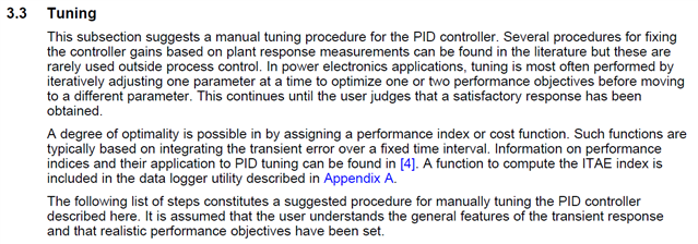

    As far as tuning the transient response goes:
    • For the 2p2z controller you will probably need a plant model to tune it effectively and we haven't provided a plant model for this design. On our newer designs we use a software library to collect data from the ADCs and get an empirical model of the plant. From there you can tune the controller, but this isn't supported in these older controlSUITE projects. You may look at the newer LLC design, TIDM-1001 in the Digital Power SDK.
    • If you use the PID controller, you can more easily tune it by looking at the transient response and updating the coefficients (Kp, Ki, Kd) based on the rise time, overshoot, and stability. This procedure is described in the Digital Control Library documentation (controlSUITE\libs\control\DCL\v1_00_00_00\docs\DCL User's Guide.pdf). Manual tuning of PID controllers is a popular topic, so it is also extensively documented online.
    Below is an excerpt from the PID tuning section of "DCL User's Guide.pdf"

  • Hi Clayton,
    Thank you for your reply.
    I'm considering using PID controller of DCL, but it seems not to support TMS320F2803x because it does not have FPU.
    And closed loop demo on TMDSHVRESLLCKIT seems to use PID controller and convert it to 2p2z controller, so is my understanding as below correct?
    ・use_2P2Z=0 //(use PID instead of 2p2z)
    ・Configure Pgain, Igain, and Dgain referring chapter 3.3 in DCL user guide
    U-SK

  • Hi U-SK,
    Sorry, I was out of office the passed week and missed your posts.
    What you've described is a fine way to proceed.
