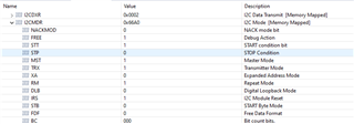

I am using an I2C example "i2c_ex4_eeprom_polling.c". At the very start of the code when the program checks for connected I2C devices it executes the following code. The "I2CBusScan", GPIO initialization, and I2C initialization are also shown. The problem I am facing is when the code reaches I2C_sendStartCondition(base); in function I2CBusScan()It sets the STT bit (shown in the attached image) high. According to the datasheet SPRUHM81 page 2331, the STT bit should come back to Zero after the I2C_sendStartCondition(base); command. However, in my case, it stays at one. When I stay at one then the condition while(!(I2C_getStatus(base) & I2C_STS_REG_ACCESS_RDY)); becomes true and the loop continues for infinite time.
Sometimes it works. But most of the time it will stick at this line. Also, sometimes when I unplug and replug LAUNCHXL-F28379D it starts working again for some time and then stops working again. I don't understand what is the problem. I am using a sensor from Analog Devices ADXL345.

  • Hi Syed,
    It will help to look at the I2CSTR bit values when this issue occurs to better understand what's happening. Also probing the I2C signals with an analyzer or oscilloscope to see the bus activity.
    Maybe the START condition is never getting generated for some reason.
    Kevin

  • I have narrowed down problem. When I debug and run the program. If it doesn't work then I disconnect the sensor (plug out +3V wire) and stop the debugging. The next time if I start debugging it will work for sure.
    If I understand it correctly if I stop debugging somewhere in the while loop( reading data) the I2C device connected will stuck ( sometimes ). Untill you turn off and turn on it will not work.
    If I load the program permanently then everytime i turn on MCU with I2C connected already i will work. My problem you can say is kind of solved. But I still don't know why during debugging, if I stop it, it hangs some where until i disconnect sensor and reconnect it.
  • But I still don't know why during debugging, if I stop it, it hangs some where until i disconnect sensor and reconnect it.
    That might be due to External Slave Device Hanging the Bus by Holding SDA Low
  • Yes, exactly this was the problem.
