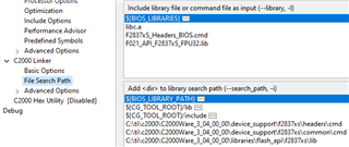

Hi
I have tried to run sys bios by create project from the following steps
1. Click "Project"
2. "New CCS project"
3. select "Sys bios" under project template and example
4. select "Minimal"
with the example of "Blinking LED" on CCS program, after debug the program, the LED on the launchpad is working okay but after board reboot (by pressed the reset button or unplug the power) the program is not working anymore... (Only red LED (D9) is on)
So I would like to ask if you have any suggestion to run sys bios pn flash memory after board has been reboot without any failure....?
main.c : https://pastebin.com/4V4TcK6G
TMS320F28377S.cmd : https://pastebin.com/TVAu20iQ
app.cfg : https://pastebin.com/Gy5kxAgH
CCS 8.3
sys/bios 6_76_00_08
xdctools 3_51_01_18
C2000Ware_3_04_00_00

  • - What is the difference between "codestart" and "c_int00". when I used c_int00 and compile the program it's show warning.
    - For boot pins I set all pins to 1 (ON), according to the schemetics of the board it should be emulator mode I'm I correct ?
    - And I would like to know how to set boot pin correctly for flash boot ?
    - About .map file do you mean .cmd right ? if yes after I created the project I only moved M01SARAM and LS05SARAM from page 1 to page 0.
  • What is the difference between "codestart" and "c_int00". when I used c_int00 and compile the program it's show warning.
    Usually we put codestart at the Flash entry point which then branches to c_int00. Using codestart (or an equivalent function) gives you a chance to execute some code before performing c_int00. For example, you may want to disable the watchdog if you expect c_int00 to take a long time to execute. One thing to note is that SYS/BIOS has its own version of codestart that is different from the CodeStartBranch.asm from C2000Ware. I'm guessing that's the one you're using but seeing your .map file should clarify.
    I think you'll need to turn off TRST to boot from flash instead of using the emulation boot settings. See if this post is helpful.
    No, a .map file is generated by the linker and shows you the addresses at which code/data were actually placed. You'll see it in the build folder in your project (by default it's "Debug" in the Minimal project).
    Whitney

  •       - One thing to note is that SYS/BIOS has its own version of codestart that is different from the CodeStartBranch.asm from C2000Ware. I'm guessing that's the one you're using but seeing your .map file should clarify.
    In my project I only add "include option C2000Ware_3_04_00_00\device_support\f2837xs\common", but I found CodeStartBranch.asm in "C2000Ware_3_04_00_00\device_support\f2837xs\common\source", So I would like to ask if "C2000Ware_3_04_00_00\device_support\f2837xs\common\source" it has been used in the program with the steps I have told you before.
        - I think you'll need to turn off TRST to boot from flash instead of using the emulation boot settings
    If i turn off TRST I will not be able to flash the program to board right ?. I have tried to flash program while turn on the TRST (Emulator mode) and then turn off TRST after finish, it still not working. I'd like to know if my solution is correct for boot from flash memory.
  • Thanks for sharing the .map file. I can see ti_catalog_c2800_initF2837x_begin at 0x80000, so that confirms that you are using the SYS/BIOS codestart and you don't need CodeStartBranch.asm.
    In your Boot module configuration in your .cfg file, can you select the option that disables the watchdog and see if that makes a difference?
    Right, you need to have it on when you program the device, but once flash is programmed, you'll want to turn it off and to see if it can boot from Flash without CCS connected. You said that you were resetting the device by using a button? Does it make a difference if you do a power cycle instead?
    Whitney
  • Thank for help
    It works after I disabled the watchdog program.
