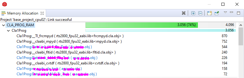

    I removed almost every program code and built my application. Below is the respective CLA program ram:
    BR,
    Lucas

  • Hi Lucas,
    I looked at the object files being mapped to Cla1Prog in the "minimal" map files. In the EABI compilation, there are object files for llc_tasks and mac_tasks but I don't see the same in the COFF version. This would be something to explore.
    COFF:
    Cla1Prog   0    00080008    0000011e     RUN ADDR = 0000a000
                      00080008    0000006e     app_cla.obj (Cla1Prog:_my_ads_cla_task)
                      00080076    00000058     cla1_math_library_datarom_fpu32.lib : CLAatan2.obj (Cla1Prog:_CLAatan2)
                      000800ce    00000038                                         : CLAsin.obj (Cla1Prog:_CLAsin)
                      00080106    00000020                                         : CLAsqrt.obj (Cla1Prog:_CLAsqrt)
    EABI:
    Cla1Prog   0    00080008    00000bf0     RUN ADDR = 0000a000
                      00080008    00000366     rts2800_fpu32_eabi.lib : frcmpyd.cla.obj (Cla1Prog:__TI_frcmpyd)
                      0008036e    000002f0                            : mpyd.cla.obj (Cla1Prog:__claabi_mpyd)
                      0008065e    00000220     llc_tasks.obj (Cla1Prog:DataLink_LLC_Rx_Task)
                      0008087e    000000f0     rts2800_fpu32_eabi.lib : fltid.cla.obj (Cla1Prog:__claabi_fltid)
                      0008096e    000000e2     mac_tasks.obj (Cla1Prog:DataLink_MAC_Rx_Task)
                      00080a50    000000c2     rts2800_fpu32_eabi.lib : cvtdf.cla.obj (Cla1Prog:__claabi_cvtdf)
                      00080b12    0000009e     app_cla.obj (Cla1Prog:my_ads_cla_task)
                      00080bb0    00000048     mac_tasks.obj (Cla1Prog:DataLink_MAC_Tx_Task)
    Ashwini
