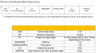

The below is the encoder format I'm testing.
The encoder consists of 16 bit Multi turn and 19 bit single turn resolution.
I modified biss.h settings
//--- TI 24-bit slave encoder definition ----
#define   BISSC_FREQ_DIVIDER                                          50    // 1MHz
#define BISS_ENCODER_HAS_CD_INTERFACE                 0
#define BISS_POSITION_BITS                                              37   // Single + Multi
#define BISS_POSITION_CRC_BITS                                    6

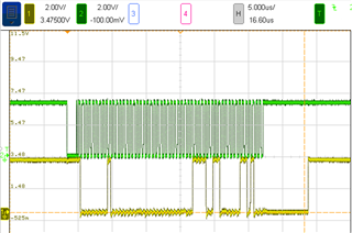

I am getting CRC errors on every transmission when interfacing to a 32bit absolute encoder with BISS-C interface.
And I found this thread and test workaround source code, but it can't fix errors
CRC Errors using BISS-C feature of TMDXIDDK379D Design Drive Kit - C2000 microcontrollers forum - C2000Tm microcontrollers - TI E2E support forums
The CrcResult is different from the bissc_data_struct_scd_src.
Encoder output waveform.
