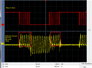

  • The INA240 sensor output is discontinuous (CH2) 2nd capture and not synchronous with EPWM modulations driven alpha/beta Vsense inputs. Even though phase current seems continuous via current clamp (1st capture) that is no indication sector rotation is keeping synchronous to/with CMPA load events via  (main_ISR) 328µs Instaspin EPWM decimation timing.
    Why does INA240 have 1/2 wave pulses in sync with EPWM duty cycles. Perhaps single unbound Clarke transform leads to ADC input signal order collisions of some kind in FAST estimator inputs?

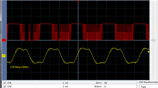

    Lab7 90Hz VSI 2ms PWM modulator versus Lab5 BoostXL-drv84320rs 150Hz PWM modulation:

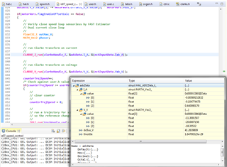

  • Seemingly format contention exist in the input data struct skipping over a 32 bit typedef word position previously compiled. Symptom (dcBus_V) exists in a previously defined struct position shown below. Seemingly a coding violation that was missed by C++ code analysis tools. BusVoltage data exist in the first Globals typedef formatted data positions and voids 32 bit word gap when R/W of Globals formatted data strings.
    Either filling or omitting trajectory data in the process but it effects the trajectory in the rotation computation speed to target. Perhaps we shouldn't label format strings with typedef parts (cheery picking) over existing 32 bit words without a symbolic name/named in a formatted R/W string and referencing a typedef Globals format.
    Seemingly Clarke digests or even omits certain data and sends it to FAST estimator, take your pick.
    My vote code 2 Clarke functions to keep inductive current (alpha/beta) and voltage (alpha/beta) data completely separate ADC input formats.
    Top Lab5 and Lab7 global names are entangled in two typedef structs using the same symbolic name for a variable not being formatted in the global name/s.

  • Point in above code being dcBus_V was not included in the EST_InputData_t estInputData sting layout even though dcBus_V is a FAST input below Clarke block. The typedef code is questionable as to how adcData.dcBusV can be temporary saved to a Non existing location of estInputData format. Also questions how Vsense inputs to Clarke are being crossed (A,C,B) when using ADC PGA_OF inputs and omitting PGA outputs via the analog sub module.
            // store the input data into a buffer
            estInputData.dcBus_V = adcData.dcBus_V;

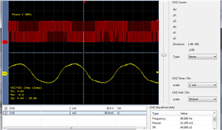

    The above captures compares BoostXL with typical VSI/VSC using proper ADC input order for Clarke Vsense and ISense channels. The PWM modulation is not keeping consistent into Clarke inputs and the synchronization is horrible in both examples the angle is skewed. Why is the order of the ADC inputs not keeping consistent in the format data strings?

    INA240 above captures (top right) CH2  shows 170ms discontinuous frames indeed occur. I don't believe 170ms voids to be scope aliasing on CH2 rather highlights discontinuous algorithm, CMPA duty cycle changes. Note too the difference PWM drive CH1 has fewer discontinuities in the same 2ms Horizontal sweep time, when Vsense order (A,C,B) on the VSI captures (left side).

    Have discovered Vsense scale factor is not being configured with any value via HAL_getVoltageScaleFactor() and negative voltage values are present input data too. Oddly the ADC has 3v3 peak 4096 count level and the Vsense analog inputs are <1.5v P2P via resistor divider. The scale factor math is corrupting the real time Vsense (EMF) values to Clarke() and FAST is by luck only approximating phase angle. The phase angle is off by nearly 15°maybe 30° best guess, thus motor will loose top speed at Max current angle.
    The Sense inputs to Clarke are not scaled to DC bus voltage levels as described SVPWM or DPWM literature. The VSI index factor (Mi) determines voltage Max of DPWM1/2 or SVPWM/DPWM1 (mixed) where U1 max = p/2v3 = 0.906p.u Mi. Seemingly the SDK has limited VSI index (Mi) to 0.5p.u Peak via fixed saturation levels HAL_writePWMData(). The math diverges and Mi can not be set >0.5pu without effecting the phase angle output from FAST estimator.
    The FAST estimator Clarke alpha beta inputs digest ADC values greater than 4096? What TI text discusses the theory or details input requirements for FAST estimator alpha beta inputs?
  • The VBus_SF decimal point is shifted to the right 1 place making 2.06 SF to be 20.6xxxx. Oddly alpha beta are smaller values but the ADC Vsense inputs to Clarke are scaled very high input values. The V_V-SF decimal point is CCS debug issue? Oddly negative Vsense are actually positive values (real time) debug watch expressions. Are the ADCdata.V_V values to be as high into Clarke, what are Max input values to angle calculations?

  • If you have a look at the codes in ISR carefully, you might find an offset is removed on both current and voltage, so the current and voltage will have positive and negative values.
        adcData.V_V.value[0] -= motorVars.offsets_V_V.value[0] * adcData.dcBus_V;
        adcData.V_V.value[1] -= motorVars.offsets_V_V.value[1] * adcData.dcBus_V;
        adcData.V_V.value[2] -= motorVars.offsets_V_V.value[2] * adcData.dcBus_V;
    Also, you can find the current and voltage sampling result is converted to floating by multiple a coefficient in HAL_readADCDataWithOffsets() in hal.h. The SI unit is used in motorControlSDK for all of the variables, so the input of the Clark is floating-point with Ampe or Volt for current and voltage.
     The Vbus_sf is not used in the latest motorControlSDK. It equals half of dc bus voltage. You might find the code below in the project that shows how to calculate the Vbus_sf for removing the voltage offset.
            motorVars[ctrlNum].offset_invVbus_invV = 0.5;   // the scale factor of half of dc bus
                    // calculate Vbus scale factor to scale offsets with Vbus
            motorVars[isrNum].Vbus_sf = adcData[isrNum].dcBus_V *
                                           motorVars[isrNum].offset_invVbus_invV;

  • so the current and voltage will have positive and negative values.
    A current (bipolar) offset is not necessary as output of PGA or INA240 respectively centers +1.65v, ZeroXing=2048 counts. Seemingly channel offset should be (<1v) subtracted results, not (IA_OFFSET_A/B/C). However the Vsence SF offset I was referring to being excessively high. It made no difference to change VSF to a static value (2.054) versus 20.54. Seemingly Clarke was not handling the Vdq signals as expected.

  • The offset on the amplifier or PGA is used to convert the bidirectional phase current to 0~3.3V for ADC, so subtracting the offset in code to convert the phase current and voltage to bidirectional value, like -n.mA to +n.mA or -n.mV to +n.mV.
    Yes, we changed the offset calibration in the latest version.
    The Clark function is open source in the lab, and FAS just needs the phase current or voltage values on alpha/beta for estimating the rotor angle and speed. Sorry, we can't provide more details about how to use these values in the FAST.
  • so subtracting the offset in code to convert the phase current and voltage to bidirectional value, like -n.mA to +n.mA or -n.mV to +n.mV.
