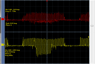

    The current wave form/s (below) are not exactly fully sinusoidal seemingly sectors are misaligned. Sector misalignment in this case results in poor peak speed at any current level, hence current oscillations start >15A peak trip CMPSSx >80Hz rotor speed @40vdc. Yet the Vsense input wave forms A,B,C to Clarke/Park are very symmetric. Again 6 step FOC via the same DC Inverter current sensors reaches >190Hz @40v.
    If the LauchXL49c has crossed J7 pins 64/65 is that not a hardware issue? Is it not proper for FE to reveal it to the community. If we have to dig Clarke/Parke transforms to verify odd crossed contention between voltage sense inputs, that is self defeating to the end cause of TI launch pads. Please verify BoostXL drv8320rs hardware issue may exist SPRUIJ3A–November 2018–Revised August 2019 as Booster header J7 pins 64 and 65 were misidentified VsenseB/C are reversed some where down the line.
    Edit: Notice there is only negative half cycles center, both ends are 1/2 wave!

  • Yesterday changed current 1nF filters to 200pF and today 2200pF. Rotor speed now reaches 110Hz and crashes rotor flux accelerating to 120Hz (0.5Hz/sec) is not a good feeling.
    The current wave form above appears to have FAST Irated control enabled, sometimes auto enables lab5 ID process EST_STATE_IDRATED. When FAST Irated auto enables motor has buzz noise zer zer zer zer zer zer  etc... Yet ID process continues on after J7 pin 64/65 reversed no longer trips CMPSSx faults and rotor accelerates again 60HZ (10Hz/sec) to finish ID process. Could it be FAST Irated (red line) switch is being enabled when it should not and distorting the current wave form when motor ID flag becomes false?

    The shape of the phase current waveform depends on the BEMF shape of the motor.

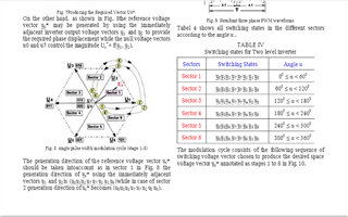

    SPV = space vector phase control.
    We use SVM or SVPWM to calculate the duty cycle for motor control.
    Right but the sector look up table should be located in SVM block, CMPA register value loaded by SVM block RAM/Flash, not ROM! Please post the code snip where EPWM module is loading CMPA register with any values of SVM block shown in Fig.55 above.  The new x49c FAST estimator topology is nothing like Fig.55
  • You might find the SVM code and calculate PWM duty cycle in SVGEN_run() in svgen.h, calculate and write CMPA in HAL_writePWMData() in hal.h. Both functions are open source in the project.

  • If you look at the  SVGEN_run() in svgen.h, the SVM doesn't need any SVM block sectors lookup table, and any SVM/SVPWM algorithm doesn't need a lookup table since there are only 6 sectors with 2-level for motor control.

    All space vector motion require lookup table to produce correct phase drive via firing each 1/2 bridge NFET frames of ld/lq orders. The fact we don't see a table as it exists in ROM. Code 000 - 111 require switch table lookup on all EPWM modules industry wide.
    The SDK or EPWM are not producing proper sinusoidal 3 phase current. Proper 3 phase current drive does not have void breaks or 1/2 wave mixed in. Trapezoidal PWM current 2 phases active 1 of 3 has off time. Yet 3 phase sinusoidal all 3 phases remain active, no breaks as the EPWM is producing. Also motor stalls, current oscillates >90Hz rotor does not reach trajectory Hz speed even driven by all 3 phases.
    Perhaps by adding 120° phase shift offsets to slave EPWMx SDK might produce always active 3 phase current sine waves?
    The float32_t Kctrl_Wb_p_kgm2 formula was not correct when BWc_rps, BWdelta are >0. The Kp_spd value was so increased motor not even start but current goes very high. Have to imagine odd errata x49c MCU where x79D MCU may differ?
  • There are different methods to implement SVM, and the method used in motorWare/MotorControl doesn't need to calculate the sector.

    The first image below is from Motorware SVM code tables for ACIM/SPM motors. Most all vendors use lookup tables to produce SVM sine wave current, why has TI vectored away from the proven method?

  • The first image below is from Motorware SVM code tables for ACIM/SPM motors. Most all vendors use lookup tables to produce SVM sine wave current, why has TI vectored away from the proven method?
    Notice the above SVM switching table notes 2 level inverter codes.  Oddly we see 170ms gaps of no current to motor 80-100Hz speed, inverter is not 7 phase controlled FOC. It seems that could be due to CMPA load truncates from x49c tool chain register directives. The load count CMPA register bits 32:16 and TBCTR bus bit 15:0, the counter has extremely high memory mapped decimal value via CCS debug. Oddly the period remains 50µs with duty cycle but FOC commutation is missing switching pulses during 170ms voids.

  • The VSI according to text must have high Mi=0.7 to produce GDSVM - DPWM0,1 or DPWMMin, Max results. The phase shift rotation approach (π/6, π/3) removes the overhead typical of CSVM rotation calculations. Again removing inline float32_t from CMPA duty cycle updates improved CPU interrupt handling of the called function times. Yet many forum posters still complain of current drive issues on custom PCB's similar to my postings but at much greater currents. My point is if SDK code can't take the heat at low voltage, low current something is the cause driving said effect.

    The INA240 sensor output is discontinuous sinusoidal (CH2) and seemingly not synchronous with EPWM modulations. Even though phase current seems continuous via current clamp (1st capture) that is no indication sector rotation is keeping synchronous to/with CMPA load events via (main_ISR) 384µs Instaspin EPWM decimation timing.
    Why does INA240 have 1/2 wave pulses in the EPWM duty cycles and bypassing Vsense inputs into Clarke transform shown as separate Block Labs guide? The FOC current sense via EPWM SOC ADC triggered interrupts for (Ia,Ib,Ic,Va,Vb,Vc) inputs are seemingly Not synchronous with FAST when Ia,Ib,Ic are externally input analog sub module.
