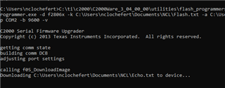

  • I am trying to use UART GPIO to flash DSP (by using sci-flash-kernel) and after that running a random program (sci_echoback for example). I use the F28069 Piccolo Experimenter Kit and TTL-R232-3v3 for USB-UART. GPIO connected are GND/3v3/28&29.
    I am using windows terminal to run program and see results.
    So I convert .out into .txt (so flash.txt and echo.txt) and then I run programs with the next line :  C:\ti\c2000\C2000Ware_3_04_00_00\utilities\flash_programmers\serial_flash_programmer\serial_flash_programmer.exe -d f2806x -k C:\...\flash.txt -a C:\...\Echo.txt -p COM1 -b 9600 -v
    And then I see :
    getting comm state
    building comm DCB
    adjusting port settings
    calling f05_DownloadImage
    Downloading C:\Users\nclochefert\Documents\NCL\Echocho.txt to device...
    Kernel AutoBaud Successful
    aa==aa
    8==8
    0==0
    0==0
    0==0
    Kernel Loaded
    Done Waiting for kernel boot...attempting autobaud
    Application AutoBaud Successful
    And after that nothing. It stays at this point and I have to make ctrl+c to take back control.
    Thanks a lot for your help, very kind.
    Nicolas

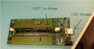

  • Nicolas, correct, that is what I mean - use a debugger. You had this before as well, and posted a picture. I just want you to repeat this again to see if it is stuck in the same location.
    Sira
  • Sira,
    Thank you for your reply.
    So, here a picture of my board to be sure that we understand each other well.
    So as I said before, I don't have a debugger to use with UART connection so I have to connect the USB and work just with USB (so I disconnect UART it doesn't useful).

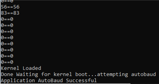

    But the fact is, in my Windows terminal, I am not stuck at the same step if I use UART or if I use USB : see screen below. That's why I am not sure that it is useful to control with the debugger from USB because UART interests me, not USB. But maybe I make a mistake and both issues are linked ...
    So on the left side, this is what I see on the Windows terminal with USB, and on the right this is with UART.
    UART seems to achieve flash kernel for two reasons :
    • first, according to terminal;
    • second, as I said before if my second program has just 3 or less characters in the .txt file, I can take back control (program switch and reads the second .txt). But if there are 4 or more characters, I am stuck at this step on the right screen.

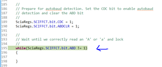

    So I come back to your request. With USB I can use debugger and I am always blocked at the same step, see screen below :
    So, as you can see on the screen, program blocks in SCIA_AutobaudLock function when SCIFFCT has to be set to 0. And if I hide this line, there is a second stop 2 lines after with SCIRXST this time.
    Many thanks for your help Sira.
    Nicolas
  • Sira,
    Sorry I have set aside this project for a while so I have forgotten to make short the terminals of J9 on the Docking Station.
    So now when I use USB I am stuck at the same point than when i use GPIO 28/29.
    So I have used again the debugger and program stops at the same point, no improvement for that.
