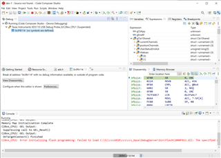

  • Hi Vamsi and Vivek,
    I went ahead and tried Vamsi's suggestion of moving the driver.
    The result is that after connecting to the running system, the Console output looks like:
    C28xx_CPU1: GEL Output:
     OnFileLoaded()
     OnTargetConnect()
     OnTargetConnect() - NOT IN realtime mode
    Memory Map Initialization Complete
     Suppressing call to GEL_Reset()
     OnTargetConnect() finished
    C28xx_CPU1: Error initializing flash programming: Failed to load C:\ti\ccs1010\ccs\ccs_base\DebugServer\bin\FlashC2000F021.dll: The specified module could not be found.
    So that makes sense, if I understand correctly what you've told me. The fact that the Flash driver DLL is missing means that the target does not get reset.
    But, what happens next isn't good yet. The debugger still says that "A Reset Occurred On The Target".
    Then when I click the pause button, the processor is not executing my code. (My code is in Flash, so it should be 0x8xxxx.) It's actually executing in the bootloader (which makes sense, if a reset occurred, right?):
    So I think I have other things to fix up. Maybe I need to discard my mods to the GEL file and start over, I might have broken something with my hacks.
  • Aha, instead I went back to just removing the GEL files from the target configuration. Seems like it works now! After I connect, CPU1 is still running. If I click pause, the debugger shows the core is running my code. I can single step, and resume, and pause again.
