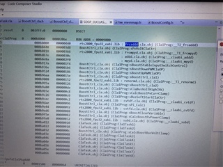

As you can see, rts2800_fpu32_eabi.lib is included inside CLA program memory.
What could be issue?

    1) In CLA, when customer writes code like a= b - c - d*0.5; rts2800_fpu32_eabi.lib will be in the CLA program code. It's not correct. In our demo code, there's no this kind of issue. We are using the same CCS and compiler.
    2) RUN = RAMLS4 | RAMLS5 | RAMLS6," works as RUN = RAMLS4. RAMLS5 and RAMLS6 are not used for CLA program code. During compiling, there's an error about memory size, RAMLS4 doesn't have enough size for CLA code. But accutually RAMLS4 | RAMLS5 | RAMLS6 is enough.

    Is the customer building the application as EABI and the demo you have is COFF? In EABI the default float size is double precision. The run time library gets pulled in for double/float conversion routines. In COFF float size is single precision and hence the same is not observed.
    One resolution is to write the 0.5 as 0.5f in code which explicitly indicates it is to be treated as single precision float.
    If this is not the case, it would also help to post any compiler warnings that were generated in the customer code.
