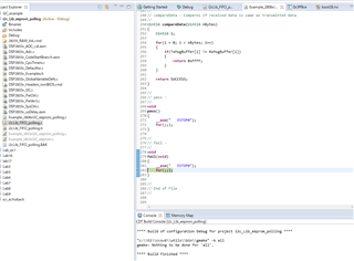

    We released some improved I2C examples in the latest C2000WARE. I'd recommend you take a loot at them and leverage the i2cLib files for your project.
    C:\ti\c2000\C2000Ware_3_04_00_00\device_support\f2806x\examples\c28\i2c_Lib_eeprom_polling
    C:\ti\c2000\C2000Ware_3_04_00_00\device_support\f2806x\examples\c28\i2c_Lib_eeprom_interrupt
    Note that the SW examples are written for the F2806x device, but they can be used for the F2833x device as well. The line below in the .h can be changed to 16 for your device.
    #define I2C_FIFO_LEVEL              16
    Kevin

  • hi, Kevin
    The latest C2000WARE has been downloaded.
    The sample you suggested was for the F2806x device, but the sample for the device you are using (F2833x) was in the hierarchy below, so I decided to use it.
    C: \ ti \ c2000 \ C2000Ware_3_04_00_00 \ device_support \ f2833x \ examples \ i2c_eeprom
    However, there is a problem.
    Since "I2cMsgOut1.MsgStatus" remains "I2C_MSGSTAT_INACTIVE", the condition on line 251 of the source code is not satisfied and it is not possible to move to the write section.
    I will attach the source code, so please let me know if there are any changes.

  • When I tried to execute it again, I was able to transition from "I2C_MSGSTAT_INACTIVE".
    However, the condition on line 389 was met and the Write section was looped by "I2C_STP_NOT_READY_ERROR;".
    Please tell me the solution.
    The source code has not changed from the one attached earlier.
    The i2c_eeprom example for the F2833x you're referencing is designed for an I2C EEPROM. It is not easy to comprehend the state machine utilized and it is difficult to leverage for devices other than an eeprom. I would not recommend using this example for reading from your temp sensor.

  • hi, Kevin
    When I run the F2806x sample, it gets stuck in the function "fail ()".
    Please let me know if there are any points that should be changed.
    You will have to tailor the code to your specific I2C device, it will not send the correct commands and meet the protocol for your temp sensor by default.You will need to reference your I2C sensor's datasheet and use the functions in the i2cLib_FIFO.c and .h source files to send and receive the correct commands/data.
    Kevin
  • I think there is no problem with the settings of i2cLib_FIFO_polling.c. However, I am not confident about microcomputers because I am a beginner. I will attach the source, so please let me know if there are any mistakes.

    That's correct, you do not need to change the 'i2cLib_FIFO_polling' file content, you can use the defined functions in your main application code for interfacing with the I2C sensor. You can increase the value of 'I2C_FIFO_LEVEL' to 16 if you like for your F2833x device.
    It looks like your "SparkFun (PID 14607) Grid-EYE Infrared Array" has an Arduino SW library that goes with it. That would probably be helpful for you to reference when building your own code.
    After you implement the functions into your own code for your specific I2C device you can share your code if you'd like me to take a look.
    Kevin
  • hi, Kevin
    Thank you for checking.
    But if the code is correct, why can't I get the sensor value?
    Even if i2cLib_FIFO_polling.c is executed, it stops at fail () as shown in the attached image. Do I need to take any other steps to get the sensor value?
    You will need to make changes to the code in Main() to match your I2C sensor. Like changing the write/read commands and sequence, configured slave address, etc.

  • hi, Kevin
    You said that you will use the "i2cLib_FIFO_polling" function and structure.
    It's already implemented that way in "Example_2806xI2C_eeprom_polling.c" and I don't know where to work.
    However, if you execute it as it is, it will still be stagnant with fail ().
    Please tell me what I should do now to display the sensor value of SparkFun.
    As I've mentioned, you will need to make changes to the code in the main project file "Example_2806xI2C_eeprom_polling.c" or wherever the main() function resides in your custom project. the example will not work by default with your specific I2C device because the read/write commands need to be tailored for your specific I2C device.
    You need to review your SparkFun sensor datasheet and develop your main() application code (using the functions / framework provided) to correctly interface with the I2C slave device. I will not do this for you, besides the hard part of developing an I2C driver is already done in "i2cLib_FIFO_polling".
    Kevin
