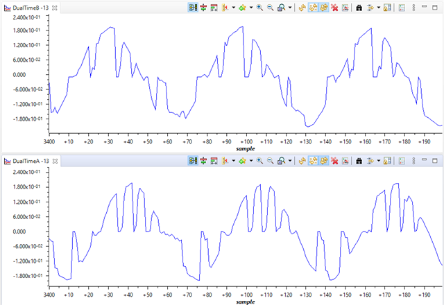

    I've identified a couple of different things that I believe are failures in the execution of the code. Firstly, when I operate at 10kHz switching frequency in Level 2, my motor angle as measured by the resolver is seen in the top graph and the rg1.Out variable is plotted below it. These are not properly in phase, that's not how it should be from what I understand, right?
    Secondly, my motor controller is designed to operate at 50kHz, so I raised the ISR frequency to 50kHz and saw 2 new issues. In the graphs below, I changed the dlog prescaler to be 25 instead of the usual value of 5 so that the graphs capture a similar number of samples per rotation.
    1. On occasion, the motor encoder position shifts to a new angle and continues from there. The encoder is very well-validated so I don't suspect that. The glitches are random and increase in occurrence at higher switching frequencies. It also occurs more frequently when I use a smaller dlog prescaler suggesting that perhaps data logging consumes precious CPU cycles and causing it to miss interrupts? I thought it might be a communication bottleneck and it's just CCS that is glitching, but the rg1 plot never shows any glitches so I don't think this is the case.
    2. The measured current glitches to 0 randomly mid-cycle before recovering to the actual value. The measured current signals are very clean and accurate at lower switching frequencies, and these glitches seem to only occur at ISR frequencies above ~35kHz so I'm suspecting a CPU loading issue. I am using the SDFM filter and have adjusted the OSR to be only 64, I also adjust the bit shift so the measured value is representable in 16bits. Are there any other settings I must change to ensure that the SDFM works correctly at higher ISR frequencies? In the graph below, I'm showing the current values for 2 of the sdfm filter outputs.

  • What could be the issue with the current measurement? Is that possibly a graphing utility error too?
    I am still having the same trouble in level 4 where the motor gets locked at the mechanical angle of 0 and doesn't move. The motor also moves in the opposite direction to get to that angle compared to the direction it moves in level 2 and 3. What are some debugging steps to resolve this?
  • If you have a current probe, that will give best results.
