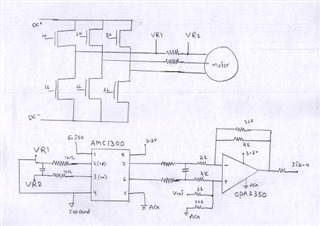

    In my custom board the current sensing resistors are present at inline, like below image, we are having 100 ohm and 2nf at input of ADC,
    is there any mistake in my circuit, because my custom board is designed for 2.4KW,
    1.is there any parameter in the code stopping my motor speed after 45 RPM with full load?
  • The sampling circuit looks good. What value is the filter capacitors on the input of AMC1300 and OPA2350? It must be smaller to ensure the delay time is lower.
