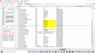

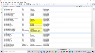

  • Hi thanks for the reply,
    1. We are working on lab08(Over modulation lab).
    2. We change the below parameters in user.h
              USER_MAX_VS_MAG_PU       0.57
              USER_MOTOR_MAX_CURRENT_A  20A
              USER_PWM_FREQ_kHz       ((float32_t)(5.0))
    1. We are facing the problem in increasing the speed, from my knowledge if we increase the Modulation index then the phase voltage also increases and speed also increases.
    2. But in this case we increased the modulation index to 0.57, and we increased the Speed reference to 30Hz(90RPM) and USER_PWM_FREQ_kHz to 5KHz, there was no vibrations while running, but speed is did not reach 90RPM( without any load on the motor), while  with load it was rotating up to 45RPM(reference speed 15Hz) only, there is no speed change after 15Hz, I  attached my watch window results( motor without load ) at Speed ref 25Hz, and speed ref 30Hz
    3. Can you please help me to solve this problem?

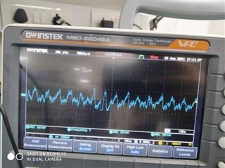

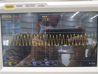

    4. And we have another problem also, if we increase the USER_PWM_FREQ_kHz to 15 or 10 or 20KHz and USER_MAX_VS_MAG_PU 0.57, my motor is vibrating  when we give speed ref 30Hz.
    Below is my watch window when we give reference speed 25Hz and PWM frequency is 15KHz
    Below is my watch window when we give reference speed 30Hz and PWM frequency is 15 KHz
    Thanks in advance and hope you address this soon.

    3. Below are the watch windows of my own hardware and Ti-hardware results (with and without load)
    We set the below parameters in user.h for both hardware
    USER_PWM_FRE_KHz     5
    USER MOTOR_MAX_CURRENT 20
    1. We used lab08 to run the motor with my drive in full load with above conditions, it tried to run but it couldn’t start to rotate at any speed setting, and my module failed. we have attached the captured current wave forms in below please review (with full load)
    2. FYI: we increased the input AC up to 260V, so that we could control the speed up to 91 RPM(with my hardware at no load) but the same did not work with load ( i.e. speed did not increase)
    3. In loaded conditions the speed increased up to 45RPM (i.e. speed reference is 15Hz), corresponding Line voltages also increased up to 139V, beyond that the speed and line voltages did not increase on increasing reference speed (i.e. 25Hz,30Hz).
    4. We have attached all the test results please review the results and suggest us to increase the speed of my motor with load.
    5. Can you please let me know is there any parameter limit the speed?
    6. As you said we tested field weakening in no load condition, we observed that up to 25Hz the motor phase currents and speed are proportional , at 30Hz the speed increased but the phase currents increased by 8 times when compared with phase current at 25Hz , can we do MTPA lab with load?(will my drive and motor be safe? FYI: my drive module maximum current is 20A)
    Watch window at lab08 results without load:
    Speed reference(Hz)
                        TI-Hard ware
                 Own hardware
    25Hz
    30Hz
    Current wave forms without Load at lab08:
    Speed reference(Hz)
                                           TI-Hard ware
        Own hardware
    25Hz
    30Hz
    Watch window at lab08 results with load:
    Speed reference(Hz)
                                    Own hardware
    25Hz
    30Hz
    Current wave forms with Load at lab08:
    Speed reference (Hz)
                                Own hardware
    25Hz
    30Hz
    Below are the test results of my hardware with and without load
    Below are the test results of TI hardware without load
