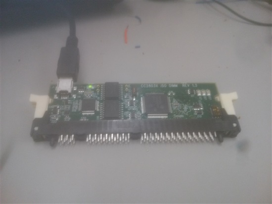

    I have the same micro-controller as Randy does and same control Card. TMS320F28035 on ControlCard TMDSCND280351SO. Image of it is below. However, I don't have a docking station.

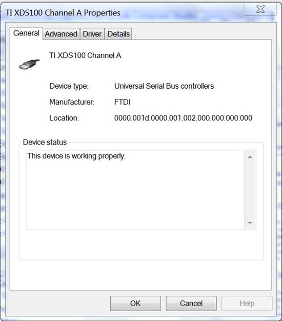

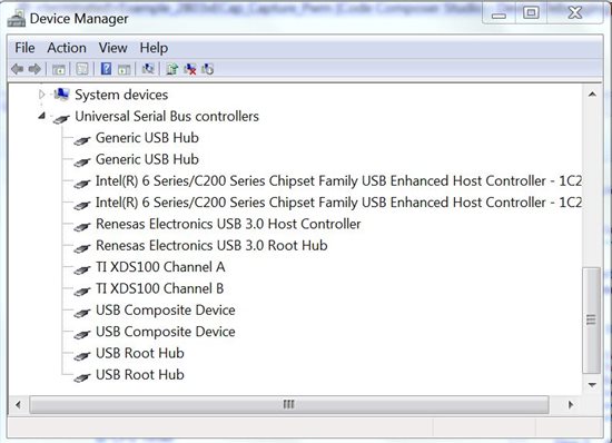

    Here are some screen shot taking from the device manager...

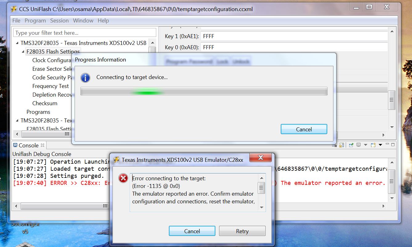

    an Image of the error
    I would appreciated if you or anyone else can suggest any solutions for this problem.

  • Osama,
    This F28035 ISO controlCARD expects power from two sources:
    1) The emulator needs power and gets this from the USB cable. If powered, LD4 should be on.
    2) The MCU needs power and traditionally gets this through the DIMM connector.  If powered, LD1 should be on.
    It appears that only your emulation path is being powered.  Because of this your MCU is not being powered and therefore you are unable to connect to your MCU.
    If you have a baseboard (like the Docking Station), it will provide the necessary 5V to power the MCU.  If you don't have a Docking Station and don't wish to use one, you could solder a 0ohm resistor between TP3 & TP1 and a different one between TP4 & TP2.  This would allow the USB power to additionally power the MCU (or you could connect an external supply across TP1 and TP2).
