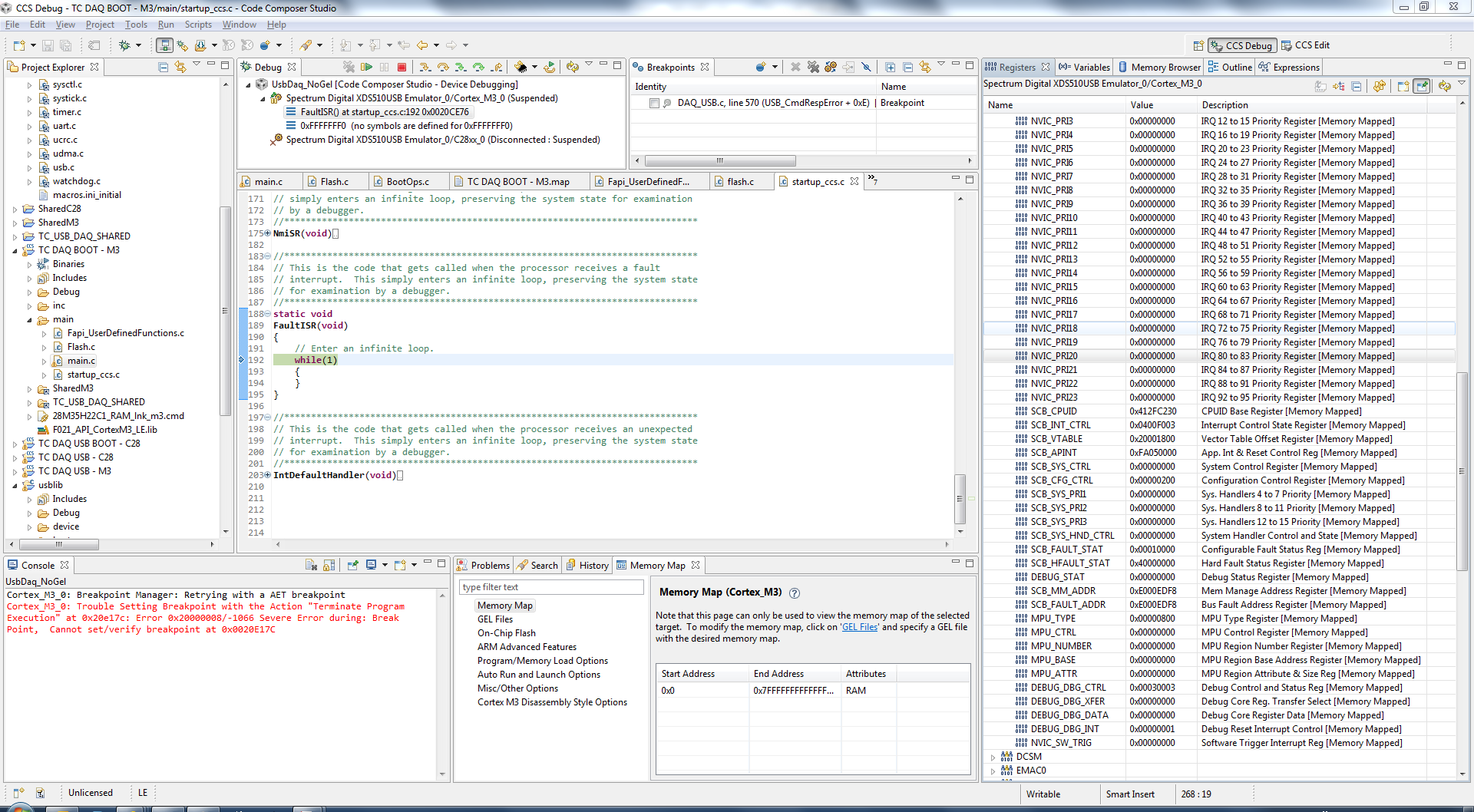

  • I have a similar situation with the F28M35.  I intend to use the m3 to reset both cores as a means to jump from runtime code back to bootloader code.
    Very infrequently, the M3 locks up in what appears to be a hard fault isr.  I was able to connect with the emulator once.  It looked like a systick exception had been declared before the hard fault isr was called as a result of trying to execute and undefined instruction.
    I've been searching everywhere to see what could cause this.  Before i do the soft reset, i call this:
    SysTickWaitHundredthSec(6);  // let usb finish
    USB_DevBulkTerminate(); // end usb
    SysTickTerminate();
    IntMasterDisable(); // make sure all interrupts are disabled before jumping
    SysCtlHoldSubSystemInReset(3); // hold in reset the C28 core and analog peripheral
    SysCtlReset(); // reset the m3
    while (1);
    I can run 20000+ cycles with a test app before i get the hard fault.  I am running out of ideas.  I found some Cortex-M3 notes that say you should issue a "DSB" command to wait for the write buffer to drain.  Is this necessary?
    Can you think of any reason i could end up in a hard fault?  It actually looked like the program counter was in args_main when the systick exception occurred.  I have the default handler there.  I guess the exception was escalated into a hard fault.  This is confusing since the systick should not have been running at that point in the code.  It just came out of a reset condition!

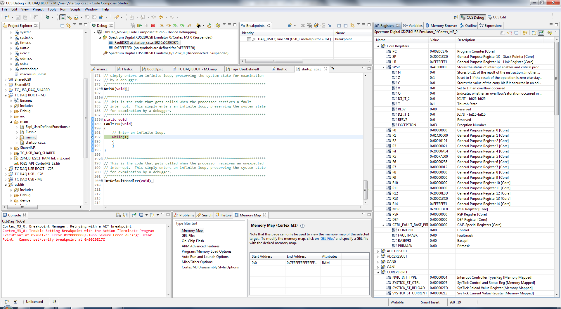

  • Here are screen shots of the registers at the time of the hard fault.  I was running standalone for the test.  Once i saw the lockup, i connected to the emulator, then connected to the m3 while making sure i didn't run gel files.
    Looking back on it i wish i had a capture of the stack, but i don't.  I know the xpsr that was thrown on the stack indicated ISRNUM = 0x3C.
  • i was finally able to fix this.  It was a usb interrupt asserted while initializing the FlashApi.  the
    USB0DeviceIntHandler is flash and was called by a ramfunc -- Fapi_setupFlashStateMachine() -- as part of flash init.
    It seems like disabling interrupts is the way to go since i can't put the entire usb lib in ram.
