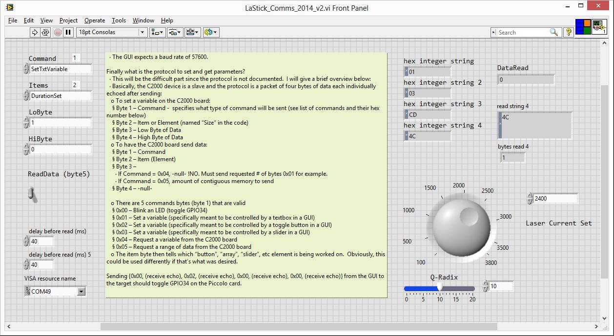

  • Unfortunately, I could not resolve the parameter format and communications packet structure. Greg posted a question and gave useful data, but I could not resolve that either. How to send commands using a terminal program, for example. http://e2e.ti.com/support/microcontrollers/c2000/f/171/p/169189/1125481.aspx#1125481

  • Adnan,
    The only real documentation around SciCommsGui and its connection to the GUI is the attached .doc file.
    Hopefully, it helps you understand things a bit better.
    If you have a specific question I may be able to help.
    Thank you,
    Brett
    SciCommsGui.doc
  • Dear Brett,
    That seems to be very useful. to clear thing a bit more, it would be nice to have your c code as well. Is it possible? I could not resolve how to select parameters "Byte 2 – Item or Element (named “Size” in the code)" for example.
    Thanks a lot.
    Adnan
  • Dear Brett,
    Thanks for the advise, and very useful document. Now I am able to control my card over serial port as expected.
    Adnan
    PS. Inspecting the c code for SciComms helped me to find the assignment of the variables to the GUI parameters.

  • Dear Hamid,
    Please find a sub-program user interface that also tells about how to use SciCommsGui. I think this might help, and this was the fastest way I could respond. Should you require anything more, I can try.
    Adnan
