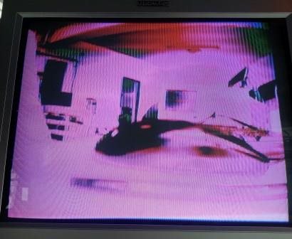

Hi all:
   I am working on a ipc project based on 8127+ad9923a+icx274.
   Now the bayer data to VO is ok, but the image is wrong.
   Here is the picture:
You can see obviously purple and vertical stripes noise.
The flow is  ISIF [1920*1252]->IPIPE->RSZ[720*480].
 After some reseach on ISS/ISP and adjust to IPIPE->SRC_COL, IPIPE->RGB2RGB1,  I can only make it change from purple to green or blue but no correct effect.
Could anyone help me?
The attachment is raw file 【720*480】 captured with DCC tool from appro IPNC RDK3.50.
