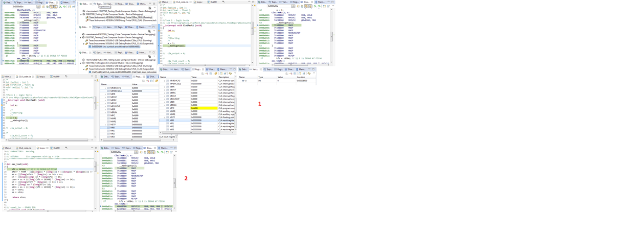

I notice some problem when I'm using CLA1 after CPU1 configuration. I use CCStudio 7 with TI v6.4.2 Compiler on F28379D target [TI v16.9.1.LTS makes a lot of #2638 error: The alignment
of an array element is greater than the element size].
Anyway, my simple test code follows a TI sketch but it sets only Task1 on CLA for easily changing a local CLA variable. The compilation steps are ok; also debug steps
improve correctly.
When I starting CPU1 code, after that I connect in debug window either CPU1/CLA1, CPU1 executes own code upto waiting in Cla1ForceTask1andWait() function: CPU1 state
is in Running mode while focus pass on CLA1 that is in Suspended mode with no symbols defined for 0x0000A000 [I know is the origin LS4-LS5 RAM assigned to CLA1 by
2837xD_RAM_CLA_lnk_cpu1.cmd]. Finally, when I load symbols on CLA1, it stops in the first C istruction that is 'a = 1'.
Follow it is the assembly code with one istruction over MSTOP.
Cla1Task1(), c:
0000a000: 78400000 MMOVIZ MR0, #0x0
0000a002: 78800001 MMOVXI MR0, #0x1
0000a004: 74C08900 MMOV32 @0x8900, MR0
43 __mdebugstop();

The questions are relative the follow event:
1) If I execute a single step, MPC arrived in 0x000a006 while the blue arrow pointed __mdebugstop() function. MR0 register would be changed in 1 value and then it will
be loaded in 0x8900 that is CLA1 Data RAM assigned for 'a' variable. If I check MR0,'a' in Variable window and 0x8900 RAM location, I don't see any right value [it
preserves 0 value]. However, If I manually change value in a Variable window or in Memory, it changes correctly. It seems that CLA have some problem with memory
control but also with own MR0 register [???];
2) If I continue with two steps, MPC overruns MSTOP CLA istruction and reaches 0x000a01e program location that it would be assigned to CPU1 code [???].
Is there somebody that clarify this behavioral ? Thank's a lot.

  • Hi Diego
    I would recommend you single step in the disassembly window. When you single step on the CLA you push the pipeline 1 cycle ahead, its different from the c28x where if you single step it flushes the pipeline and simply executes 1 instruction. In the disassembly window you will need to single step a couple times till the  MMOVXI MR0, #0x1 instruction gets into its execute phase and MR0 actually gets loaded with 1. You then step an additional two times for MMOV32 @0x8900, MR0 to get into its write phase and the value in MR0 gets written to the address 0x8900
    the CLA stops execution when the MSTOP reaches the D2 (decode 2) phase in the pipeline. At this point the CLA will fire an end-of-task interrupt to the PIE.
    I created a video on CLA debugging a while back, it covers the pipeline in a bit more detail.
  • Hi Vishal. Thank's a lot for your help.
    It's one day that I try to understand what's happen. I prove now your advice but, unfortunately, it doesn't work. If I use 'Assembly Step Into' button, I see either MPC and Disassembly window's code continues by single step but, although I cover the follow assembly section code, any changing in register or memory take place (pipeline is 8 stages and D2 is the 4th, if I not in wrong; I try for 14 steps...).

    In particular, If I try to change CLA's MRx registrer, that would be R/W also in debug registers window, nothing happen; also with an assembler istruction! I try to change TI 2837xD_RAM_CLA_lnk_cpu1.cmd copied in my code folder but I don't find a workaround [Es. I split RAMLS4 & 5 with Cla1Prog : > RAMLS4, PAGE=0; CLA_SCRATCHPAD_SIZE = 0x100 -> 0x200 but nothing changes.
    Is there something test that I prove for debug this situation? That's happen also with cla_logig_cpu1 example.
    Diego.
