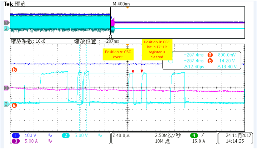

I would like to use F28023's epwm works in CBC mode, and require epwm to be latched after CBC occurs in 5 consecutive switch cycle.
But I got a problem that PWM doesn't works in CBC mode if I clears TZCLR register. It seems that TZ condition disappeared after TZCLR register clears. Can you please share your comments on this?
What I doing sequence shown as below:
In each pwm period isr:
- read TZFLG to see if CBC occurs
- If CBC, then count the number and set TZCLR register(it will cause pwm issue), if consecutive 5 pwm cycle, latch pwm
- else clear counter
Here is my test wave, the normal pwm period is 50us, but the pwm cycle is changed after Clearing TZCLR register.

  • Hi Cody,
    Please note that my request is that epwm should be latched after 5 or 10 consecutive CBC occurs, and epwm should be tripped by CBC events.
    It seems that you still don't understand what issue I have gotten.  Please see below waveform that I have put some marks on it. The position A is the CBC events, I clear the CBC bit of TZCLR register at position B. It looks to me that EPWMxA was tripped by CBC, but EPWMxA pull high again after clearing the CBC bit in TZCLR register, this is not what I want. I want the EPWM turns on in next switch cycle instead of this cycle. Hope you've understood my situation.

  • Jack,
    sorry for the delay. Clearing the TZFLG.CBC will not affect the output of the PWM, the only event that clears a CBC trip is Counter=0. This feature is very well tested so I don't think there is a bug there.
    There are two things in this circuit that can also force the PWM output low, and be cleared at any point.
    1. The one-shot trip, if configured this can force the PWM low and writing to TZCLR.OSHT will clear the trip.
    2. The Digital compare event  (DCAEVT1, DCAEVT2, DCBEVT1 OR DCBEVT2) can force the PWM output low. If the comparator event is cleared then this will cause the trip event to clear at any point.
    If you made the modifications to your code suggested earlier in this thread, then I think that the Digital Compare event is forcing the PWM output low, not the CBC trip.
    Cody
  • Hi Cody,
    I know that CBC trip is well tested and works good, but what I need is that EPWM should force to low after 5 or 10 consecutive CBC occurs. Is it possible to do for this chip?
  • Jack,
    yes, you should be able to force the output low after x number of consecutive CBC trips.
    I would use a very similar scheme as to what you have tried:
    1. Setup the ePWMx ISR to interrupt at TBCTR = 0
    2. Disable all DCxEVTy
    3. Disable OSHT trips
    4. Set CBC trips to force low
    5. Write a ePWM ISR
      1. Increment a variable if the CBC flag is set else clear the variable
      2. If variable is > threshold reconfigure AQ or TZ to shutdown the PWM
      3. Clear the CBC flag
      4. Acknowledge interrupt
    Is anything unclear?
    Cody
