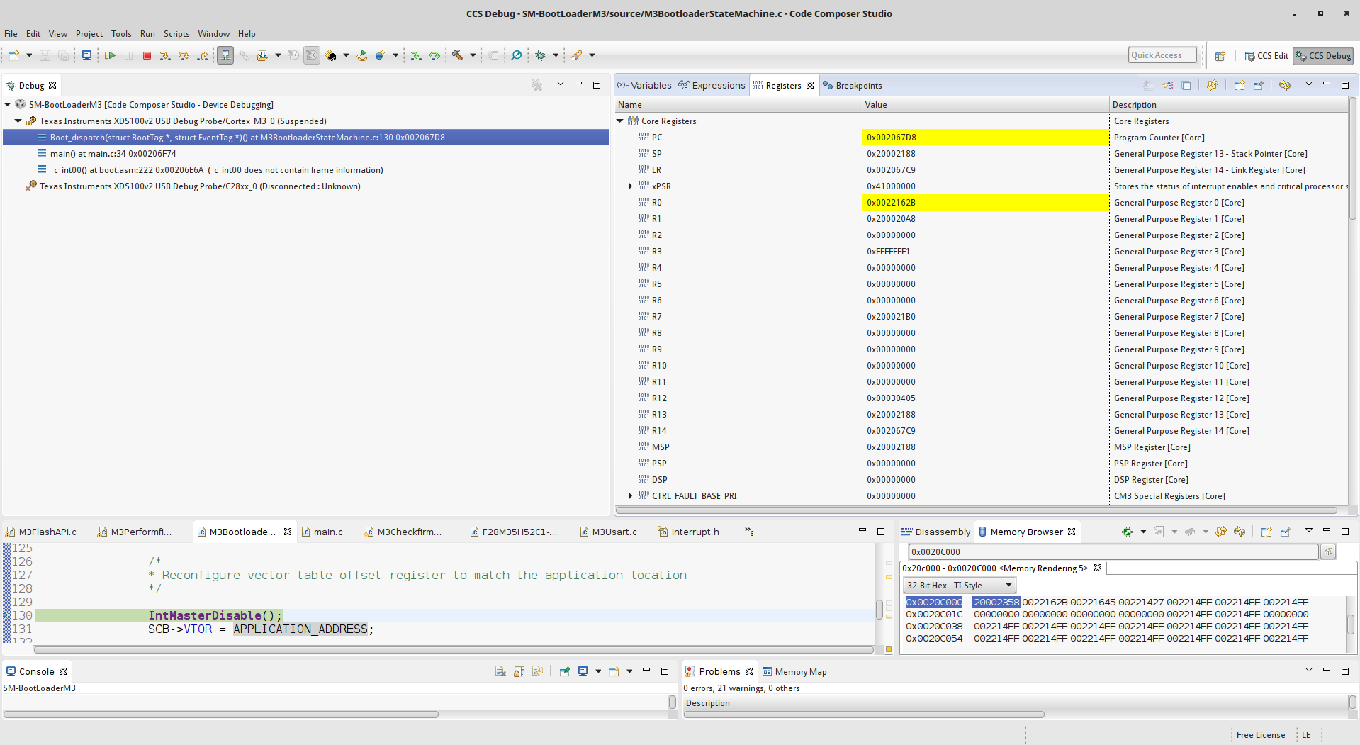

Once I write the respective parsed hex file in to the Flash memory and try to make a jump in to the blinky application the console throws a message saying "No content in location 0xfffffffe". But my reset vector for blinky application lies in location 0x0022162B and this is where i am trying to jump. I could see the contents in Disassembly window as well.
But what was not making sense was stack end address value of blinky application. This particular value when looked in vector table inside Memory region window after flashing is 0x20002358. But when i try to read the value from the Bootloader the value is 0x21002358 !! I can not understand whats going on here as i see the rite value in Flash Memory region but different value when i read it through software ??
Some Troubleshooting:
When i flash the blinky application program using TI flash utility by specifing sectors K to A and flashing Bottloader which is specifically for sectors N to L with out erasing blinky application, i could easily jump to blinky application with same reset vector address. But with out a problem in reading the stack end address which appears to be same as the one in Vector table.
But the problem seems to occur if i try to erase and write the flash contents through Bootloader and try to make a jump.
Below are some screenshots.
1. This is where i have captured appstack value. which shows a comparison btw what i read and whats in vector table address.
2. What i see when i make a jump from Bootloader
3. I tried to have a breakpoint on 0x0022162b to try step by step debugging in disassembly but this seem to not work for me either.

    Now when i try to read the value ( appstack ) of __STACK_END of blinky application which resides at 0x0020C000 it reads as 0x21002358 but the value is actually 0x20002358 both confirmed from memory view and blinky map file. This is what i was trying to explain in my question.
    Now this looks like a stack overflow for me, can you please confirm if this true. May be this is the reason i am not able to jump to blinky application.

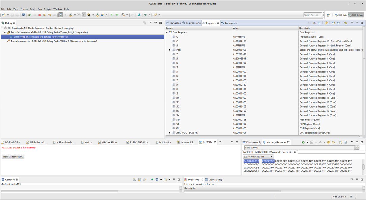

  • Santosh,
    I tried your way which will increment the address of application RestISR. (from 0x0022162B to 0x0022162C).
    But i still could not  jump to the RestISR, I am still receiving the same error message as posted in my first question.
    But what i do not understand is why is the Stack Pointer value when read displays 0x21002358 when the actual value seen in the memory window is 0x20002358 ?
    My observation:
    So when i only try and read the stack pointer value like below
    appstack = *(uint32_t*)(0x0020C000);
    I should read 0x20002358 but instead i read 0x21002358. This is where i guess problem lies. Can you help me understand this situation.

    What happens if you force PC to 0x2216A by modifying the PC register from CCS? and try to execute the B.W instruction at 0x22162A? Without changing any SP?
    I tried changing the PC value to 0x2216A from the Registers section and branch, but it resulted in the same situation. SP was not altered !!

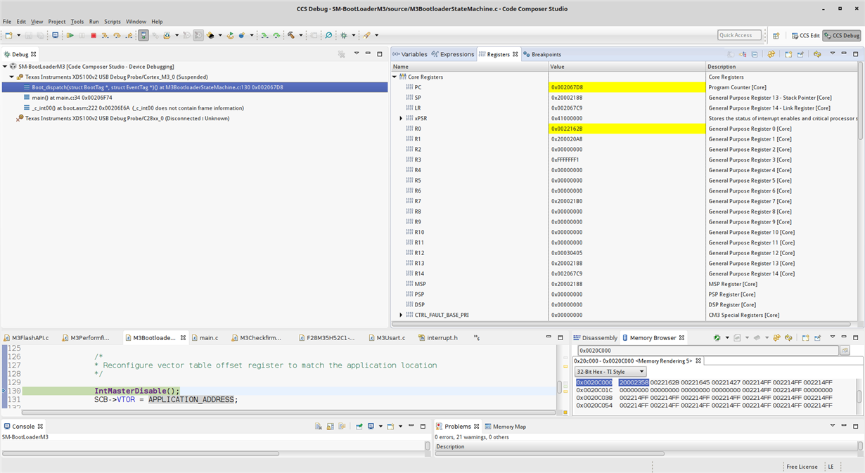

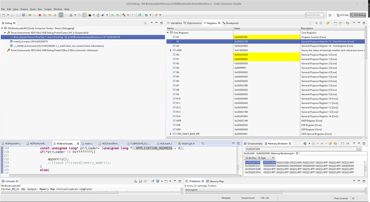

    can you put a snapshot of the SP and CPU registers window before you execute the branch and after you execute the branch to reset vector?
    the Address range 0x21xx_xxxx is invalid. Also before you switch the VTABLE and after you switch the VTABLE?
    This snapshot shows the sp and cpu register values before the branch but after the VTABLE switch .
    This below snapshot shows the sp and cpu registers after the branch
    Below snapshot shows the sp and cpu registers before the vtable switch

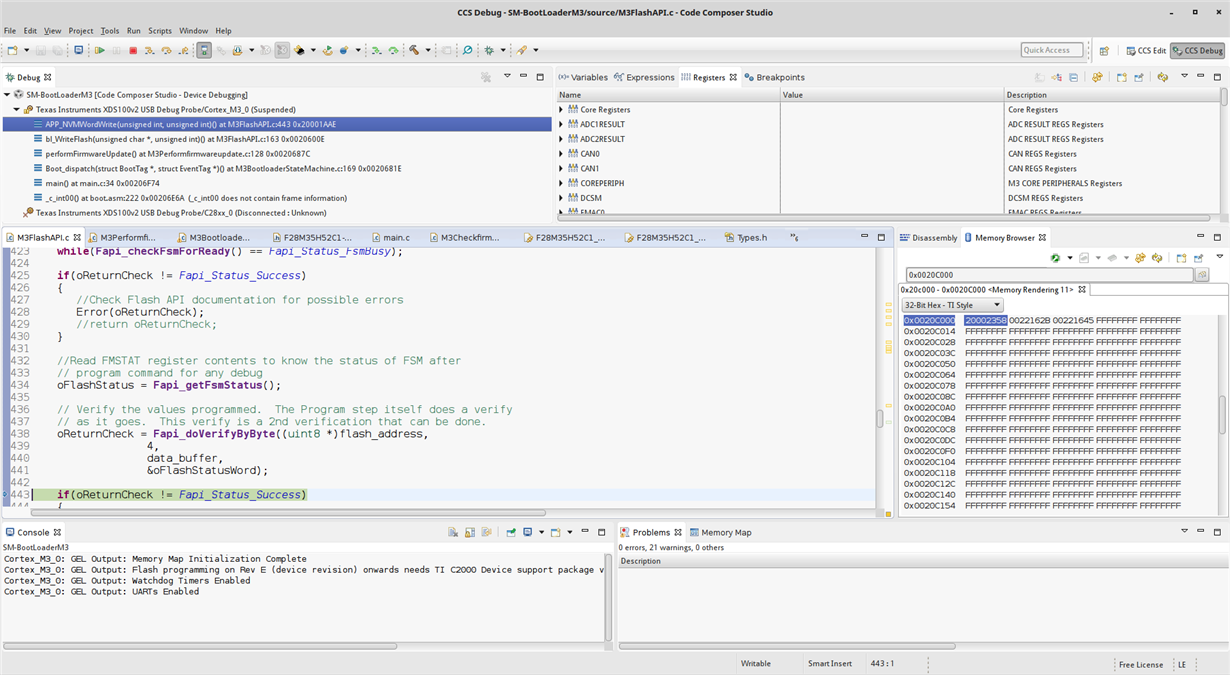

  • I have two different functions which handles Erase and Write operations.
    I do not enable or disable ECC during Erase operations. So i completely erase all the sectors before i start writing.
    Now during write operations. I disable ECC first and once the Write is successful i will enable it back.

  • I accidentally pressed the Green Button !!!! The issue is still not resolved. Can you please help me reset this ?
    I get some different error now when i enable the ECC before writing. When i call FLASH API "Fapi_doVerifyByByte" the system is pushed in to FaultISR routine !!
    I referred to the FLASH API code from Control suite and this is how it was done. The ECC is disabled before calling this api "Fapi_issueProgrammingCommand" and enabled again once done.
    I do not use the ECC in my Blinky application, so i guess it should be enabled by default when i load using CCS

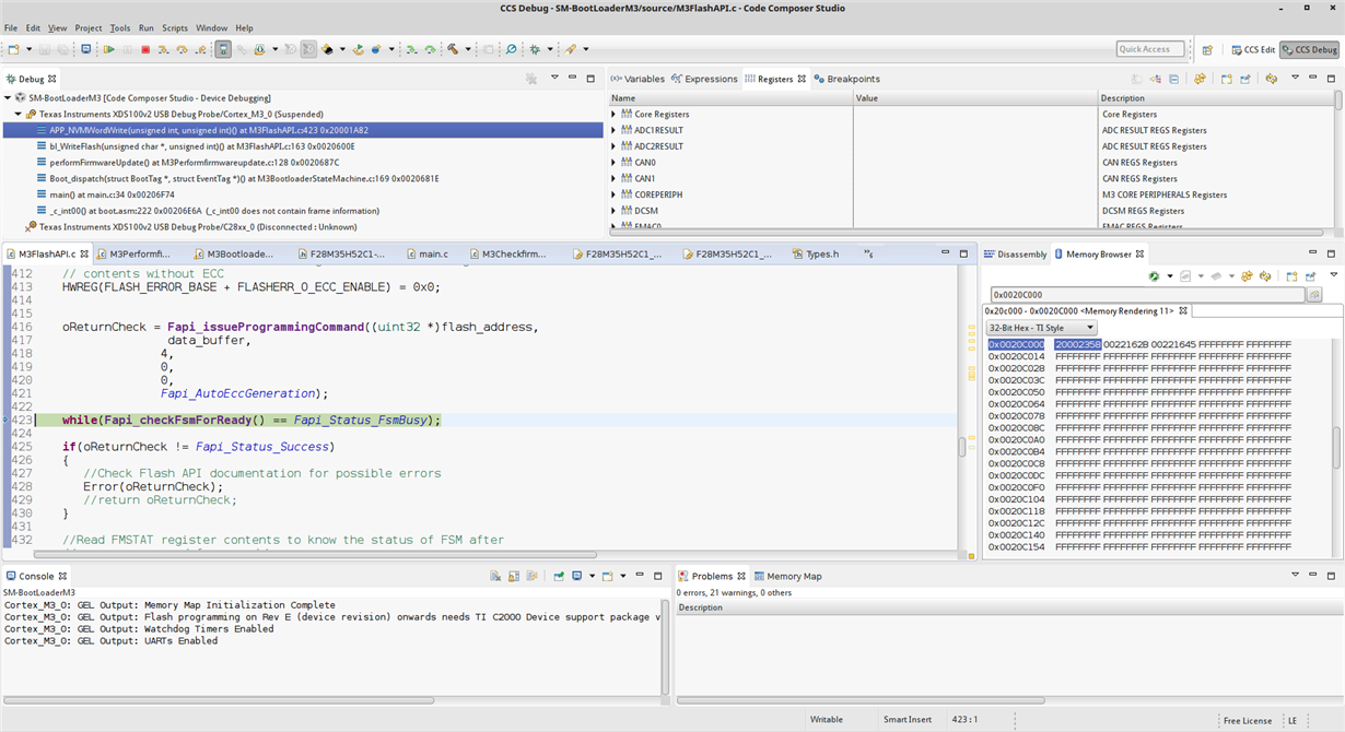

    While i am going through the FLASH API document thoroughly, I tried something  as suggested by you guys. I passed Fapi_AutoEccGeneration to the last parameter of Fapi_issueProgrammingCommand API, where as before i was passing Fapi_DataOnly.
    Now after this above change i have started to see different behavior as explained below.
    Once i start programming the FLASH with Fapi_AutoEccGeneration being used, I start writing  from FLASH location 0x0020C000 and go up to 0x0020C00C. Until 20C00C i program valid data in to each flash byte locations. But exactly at this location when i pass the address and data to Fapi_issueProgrammingCommand it returns  Fapi_Status_Success but when i actually look at the FLASH memory location nothings being written ?? Below are some screen shots.
    Can you please help me understand why i am seeing this above behavior ??
     In the below screen shot it depicts when i try to verify the content of the FLASH with data variable i get a error and land in a endless while i loop.

    Can you please try writing 16 bytes together instead of 4 bytes 4 times? It will also reduce the number of function calls.
    Let us know if you still see the issue.
    Katta
  • Preetham,
    Search for "When using Fapi_AutoEccGeneration mode, what is the minimum number of 16-bit words that can be programmed?" in the Flash FAQ page: processors.wiki.ti.com/.../Flash_FAQ
    Thanks and regards,
    Vamsi
  • Thanks Vamsi,
    I suspected the problem could be in the way i pass the number of data bits to program. Let me try changing my software to program a minimum of 64 bits at once and see how it goes.
  • Thanks for all your support guys! Really appreciate the patience and time ! Finally i got this first revision of my project working.
