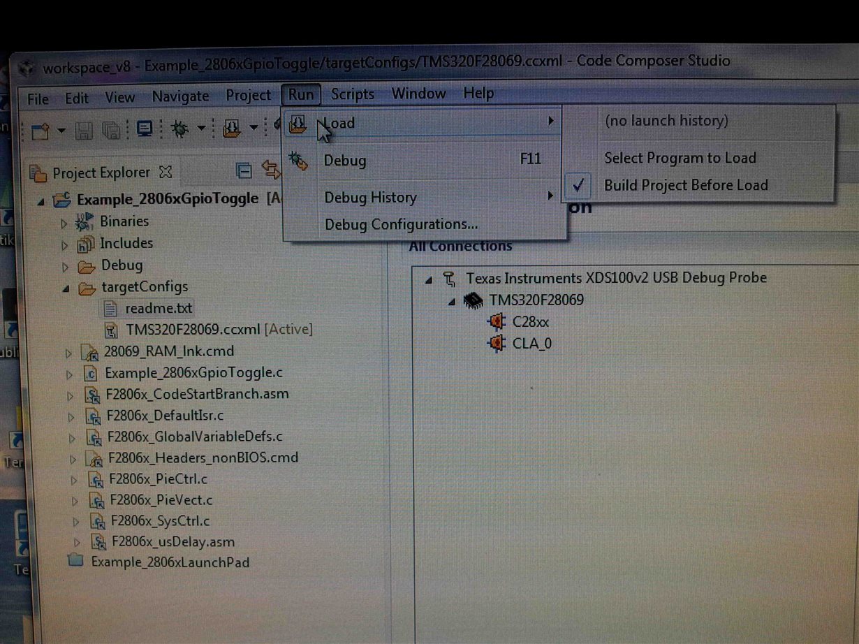

Trying out the Example_2806xGpioToggle.c with a LAUNCHXL-F28069M V1.2 located in
C2000Ware_1_00_02_00\device_support\f2806x\examples\c28\gpio_toggle
with CCS Version: 8.0.0.00016, I get this error, when I try to
Run->Load->Example_2806xGpioToggle
"C28xx: Error connecting to the target: (Error -1135 @ 0x0) The debug probe reported an error. Confirm debug probe configuration and connections, reset the debug probe, and retry the operation. (Emulation package 7.0.188.0) "
AFAICS, the debug connections are on the Launchpad itself, so likely no issue in the connections. I dont see how it is possible to reset the probe either.
Any idea, why the probe seem unable to connect to the F28069 ?

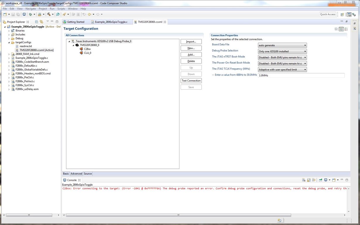

    Fiddling around, reading the docs again, came up on this note in sprui11.pdf
    "Keep in mind that the debugger does not connect if the device is not in the emulation boot mode (TRST
    switch in the up position)."
    So,  moving S1::3 = ON, tried again.
    This time the debugger connectivity issue vanished as you can see, but still the error remains.
    "C28xx: Error connecting to the target: (Error -1041 @ 0xFFFFFF6A) The debug probe reported an error. Confirm debug probe configuration and connections, reset the debug probe, and retry the operation. (Emulation package 7.0.188.0) "
    In addition, I saw it on the wiki XDS page to set the JTAG CLK frequency to "Adaptive" (Attached screenshot)

    The error still exists, any suggestions ?
    Manu

    But after installation, The Run->Load menu itself appears slightly different, it says no Launch history.
    Attached picture:
    If I try to do Run->Load->Select Program to Load, the menu after selecting the program to load, it says:
    Any idea, what's wrong ?

  • I'm not familiar with that way of launching a debug session. Try a different method:
    1. Go to View->Target Configurations to open the Target Configurations window if you haven't already.
    2. Expand Projects->Example_2806xGpioToggle->targetConfigs, right click on the .ccxml file, and select Launch Selected Configuration.
    3. In the Debug window, right click on the C28xx and hit Connect Target.
    If that's successful, hopefully you'll be able to go to Run->Load->Load Program and get your project loaded and running.
    Whitney
  • Thanks!
    That did the trick.
    Manu
