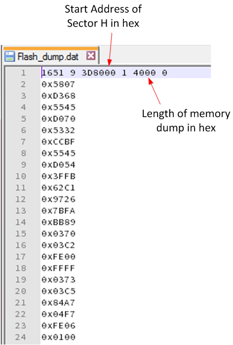

  • Parag,
    When you dump the content of flash memory say sector H. It would look as shown below (this is the hex file I'm talking about)...
    Once you have this file, you can load his file in RAM buffer in two different ways..
    1) Change the start address 0x3D8000 to RAM buffer address and load the .dat file into RAM buffer using CCS memory load option
    2) Assign the hex code to memory section ,save that file as .asm file, include that .asm file into your project and assign that section to RAM buffer in the linker command file (.cmd)

    3) Once you have the hex data in RAM buffer, you can have Flash_Program() to program flash.
    Hope this helps.
    Manoj
