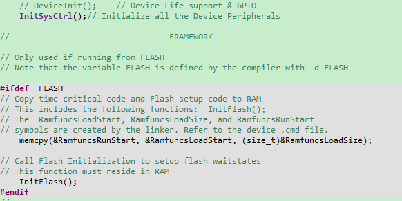

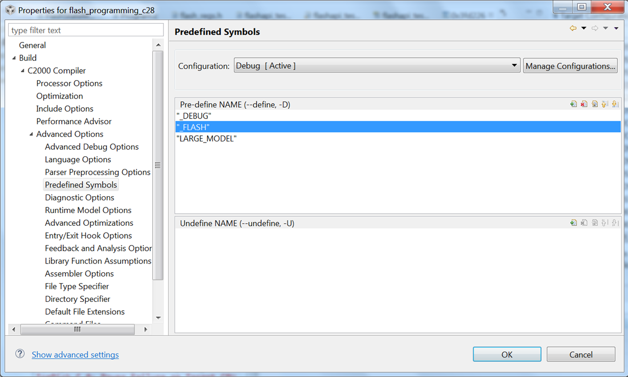

When i try to run my C28 code, i fall into the illegal instruction trap. I thought i might have a stack overflow/memory range problem and looked at my memory allocation and didn't find anything particularly alarming. my .text file is in Flash A which still has over 35% memory space. i have attached the pictures of my memory allocation below. Would you please tell me what i might me overlooking here or any other suggestion to fix this is welcome.
I also have the memcpy function () defined to copy things from Flash to RAM.
#ifdef _FLASH
// Copy time critical code and Flash setup code to RAM
// This includes the following functions:  InitFlash();
// The  RamfuncsLoadStart, RamfuncsLoadSize, and RamfuncsRunStart
// symbols are created by the linker. Refer to the device .cmd file.
    memcpy(&RamfuncsRunStart, &RamfuncsLoadStart, (size_t)&RamfuncsLoadSize);
// Call Flash Initialization to setup flash waitstates
// This function must reside in RAM
    InitFlash();
#endif

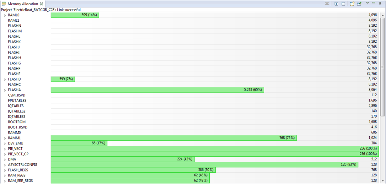

  • Hello Ozino,
    I have gone through the trouble shooting guidelines for illegal instruction trap provided on the wiki page. And it is after that did i share the issue i am facing. I have ensured that all the functions were copied properly from flash to RAM. And this is also included in the SysCtrl.c file.
    Also, I have looked at my memory allocation and attached it in the original post and i ensured my .text file is in a sufficient memory region and made sure i allocated sections to all the RAM functions. I can't put a finger on what i could be doing wrong or if i am missing something.
    Would there be something else i could try doing to solve this?? I have tried other projects and they build executables and run just fine. So i can rule out my Hardware as well. Running out of ideas now :) .
    Thank ou,
    Srini

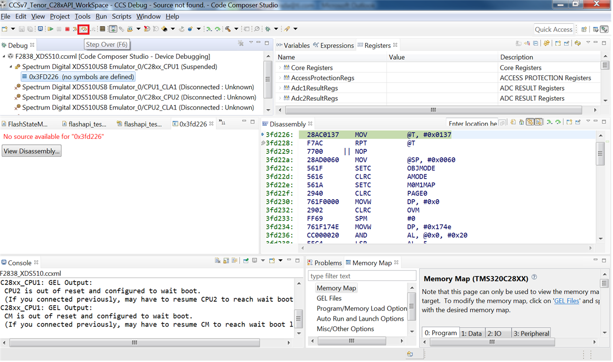

  • Srini,
    Did you figure out the exact instruction in your application that is causing this? If not, please do step execution and see where this happens.
    Since you said you already checked out things like stack overflow, I would like to ask if you noticed any Flash ECC errors when you see the trap? Please check.
    Thanks and regards,
    Vamsi
  • Hello vamsi,
    Thanks for your time. Would you please elaborate on how i can check these Flash ECC errors and do step execution as you mention?? This is what i see when i run the C28
    and inserting breakpoints doesn't help as it halts at the very first line of code.
    Srini
  • Srini,
    For ECC errors: Please look at 5.4.4 Control Subsystem Flash ECC/Error Log Registers in TRM.  Make sure ECC_ENABLE is enabled in your code (refer to InitFlash()).  When itrap occurs, check the SINGLE_ERR_ADDR and UNC_ERR_ADDR registers in the registers view.
    Single step: In CCS debug view, use the Step Over button (F6) available in top toolbar (see attached image) instead of resume button.  You can step through each function/instruction using this.  You can use Step Into button if you want to enter a function to step through it.  I will ask our analog experts to help you, since I see InitAdc1() as the last executed function.
    Thanks and regards,
    Vamsi

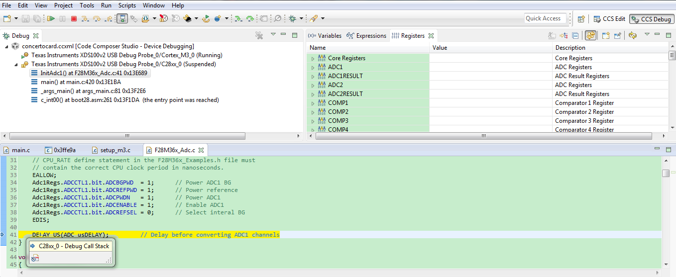

  • Hello Vamsi,
    I looked through my Initflash() function and i can confirm that i have enabled ECC. But when i look at that Register's contents in Register view, it reads 0x00000000. Also when the trap occurs, the contents of  SINGLE_ERR_ADDR and UNC_ERR_ADDR registers are also 0x00000000.  Please look at image below, i have highlighted the registers and the piece of code where i write 0xA into the ECC_ENABLE register.
    And i stepped into my code line by line and the trap does occur in the InitAdc1(). and it occurs right after the highlighted line of code in the below image
    Any suggestion on how i can fix this,
    Thank you for your valuable time and assistance,
    Srini
  • Srini,
    DELAY_US() is supposed to be executed from RAM. In F28M36_usDelay.asm file, you might have noticed that this is assigned to .TI.ramfunc section. Did you use memcpy() function in your application to copy the .TI.ramfunc contents from Flash to RAM before DELAY_US() is executed?
    In your linker cmd file, you can notice that .TI.ramfunc is mapped to Flash for load and RAM for run.
    Thanks and regards,
    Vamsi

    All the functions that i want to run from RAM are assigned to section "ramfuncs" in SysCtrl.c file
    #pragma CODE_SECTION(InitFlash, "ramfuncs");
    #pragma CODE_SECTION(SetupFlash, "ramfuncs");
    #pragma CODE_SECTION(FlashGainPump,"ramfuncs");
    #pragma CODE_SECTION(FlashLeavePump,"ramfuncs");
    I made a few changes to my Linker cmd file, i no longer have the .TI.ramfunc in my linker .cmd file. Please see below,

    And this is the piece of code using the memcpy() function,
    #ifdef _FLASH
        InitFlash();
    #endif

    The trap still occurs when the DELAY_US() function is called inside the InitAdc1(). And the ECC_ENABLE register still read 0x00000000. I double checked to see if all the functions are assigned to .TI.ramfunc()
    Here's something i find peculiar, in the image below, do you think it's odd that the InitFlash() function is not highlighted in blue. For Ex, like the InitSysCtrl() function?
    Srini
  • Srini,
    Make sure "_FLASH" is added in predefined symbols in project build settings.  See below.
    Then your memcpy() and InitFlash() get compiled.
    Thanks and regards,
    Vamsi
  • Vamsi
    Yes !! Once i added the symbols, the functions were compiled and my trap was also fixed. Runs fine now. Thank you so much for your time and all the assistance ! :)
