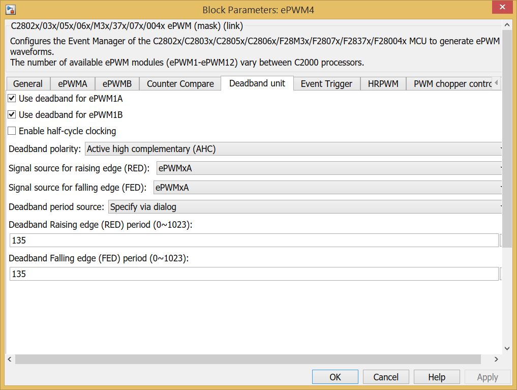

Hello Guys!
I think you will answer my question very fast, but I am l littlebit uncertain about the deadband unit end the EPWMxB.
So, I am using F28069M based launchpad and I am using MATLAB Simulink for Code generation. I have read the Simulink reference of the EPWM
modules and I am also using TMS320x2806x Piccolo Technical Reference Manual (spruh18g).
I understand how the deadband unit works, but I don not know whether I have to enable EPWMxB ?  As I have read, the deadband unit could use
only the EPWMxA signal to generate the appropriate output signals. But in this case do I have to enable the EPWMxB on the third tab?
And this is my config for the deadband unit. It will be used for an inverter using 1.5us deadtime.
