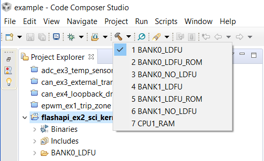

    I'd like to erase the flash and loads and programs an application into flash (with Piccolo F280049C controlCARD). When i rebuilded the .txt files i saw that the original projects have several build configurations:
    - flashapi_ex2_sci_kernel
    - led_ex1_blinky
    Could you tell me the correct build configurations to load and run an application into flash?

  • For the kernel use the RAM configuration since the boot loader can only load code into RAM.
    For the blinky flash application ,use CPU1_FLASH since the kernel will use the flash API to program the application.
    Also make sure the kernel is using the same SCI pins that you are using in your boot loader.
    sal
  • Thank you very much Sal! It works!
