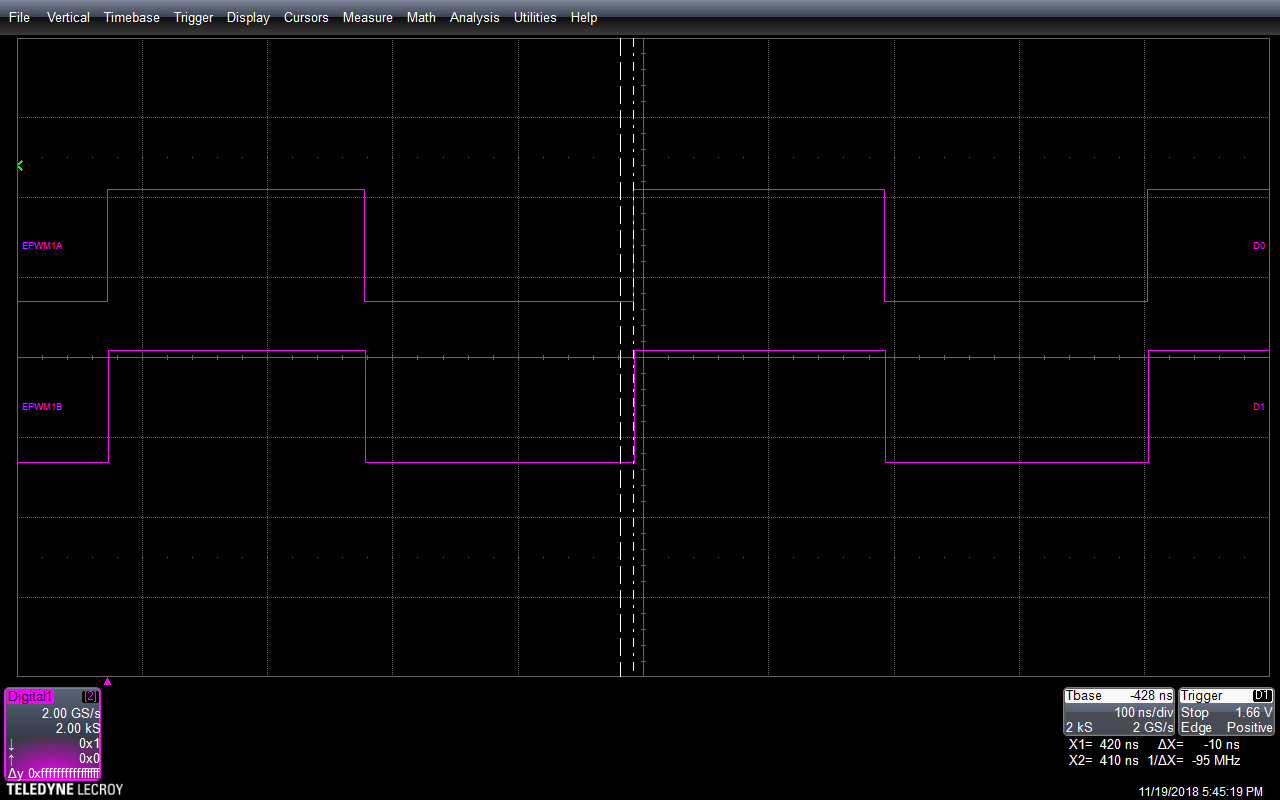

i want to use the HRPWM module to generate a PWM signal at 2.5MHz. I tried the different configurations but their are still some problems.
By using the up-count mode the HR dutycycle works, if the PRDHR register is zero. But as soon as I set the PRDHR value to unequal zero, I get jitter on the generated signal.
I started with the hrpwm_ex2_prdupdown_sfo_v8 example and changed count mode and action qualifier configuration. Please see following code:

For demonstration I set period to 40 and PRDHR to 128 (see code above). In the scope screenshoots you can see, that the second pulse jitters by 10ns (1Sysclk). The third pulse stay stabil. By other values the following pulses jitter also.
Can anybody help me with this? Is in the config a fault?
Is there a restriction by using HR dutycycle and period control at the same time? I found in the Reference Manual only Duty Cycle Range Limitation, but this is not concern this here (CMPx is period/2).

    I tried now to config the deadband module. On EPWM1 the deadband is enabled in "Active high complementary" mode. So the rising edge of EPWM1xA will be delayed. For channel B the falling edge of A will be delayed, and the signal will then be inverted. For comparison I enabled also EPWM2. EPWM2A is set on ZRO and cleared on CMPA, EPWM2B is set on CMPA ant cleared on PRD.
    As you can see in the screenshot of the scope, there is some jitter at the rising edge of EPWM1B (point in time equivalent to Counter=Zero). In the image I overlayed screenshots of the two extreme cases, but there are also edges between them.
    Here the PRDHR register is unequal 0. If PRDHR = 0, there is no jitter.
    So this seems to be the same problem like above (Jitter when Action Qualifier on CTR = ZRO). But interesting is that the rising edge of EPMW1A is stable, which means that the Deadband Rising Edge Delay compensate the jitter on the zero edge. Is that right?
    How can I avoid the Jitter on EPWM1B?
