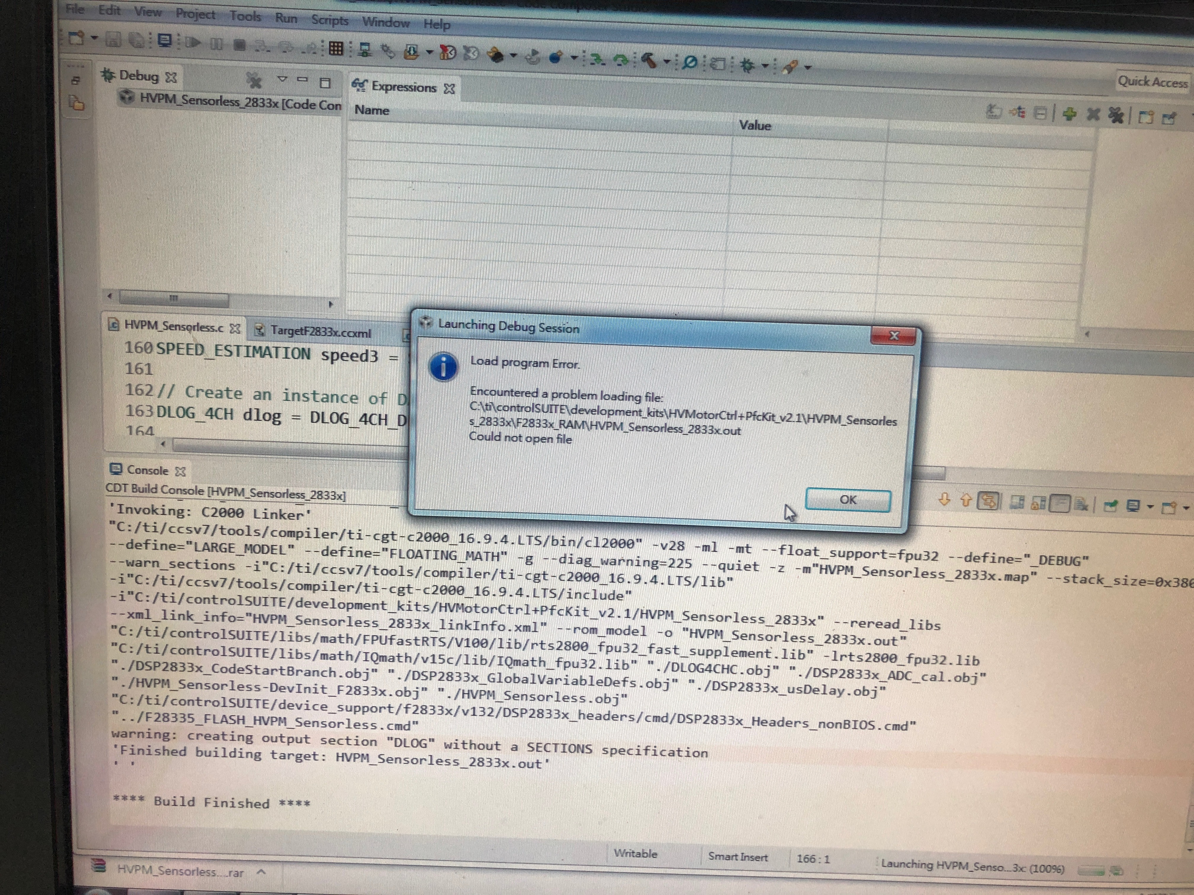

CCS/TMS320F28335: encountered a problem loading file
Part Number: TMS320F28335

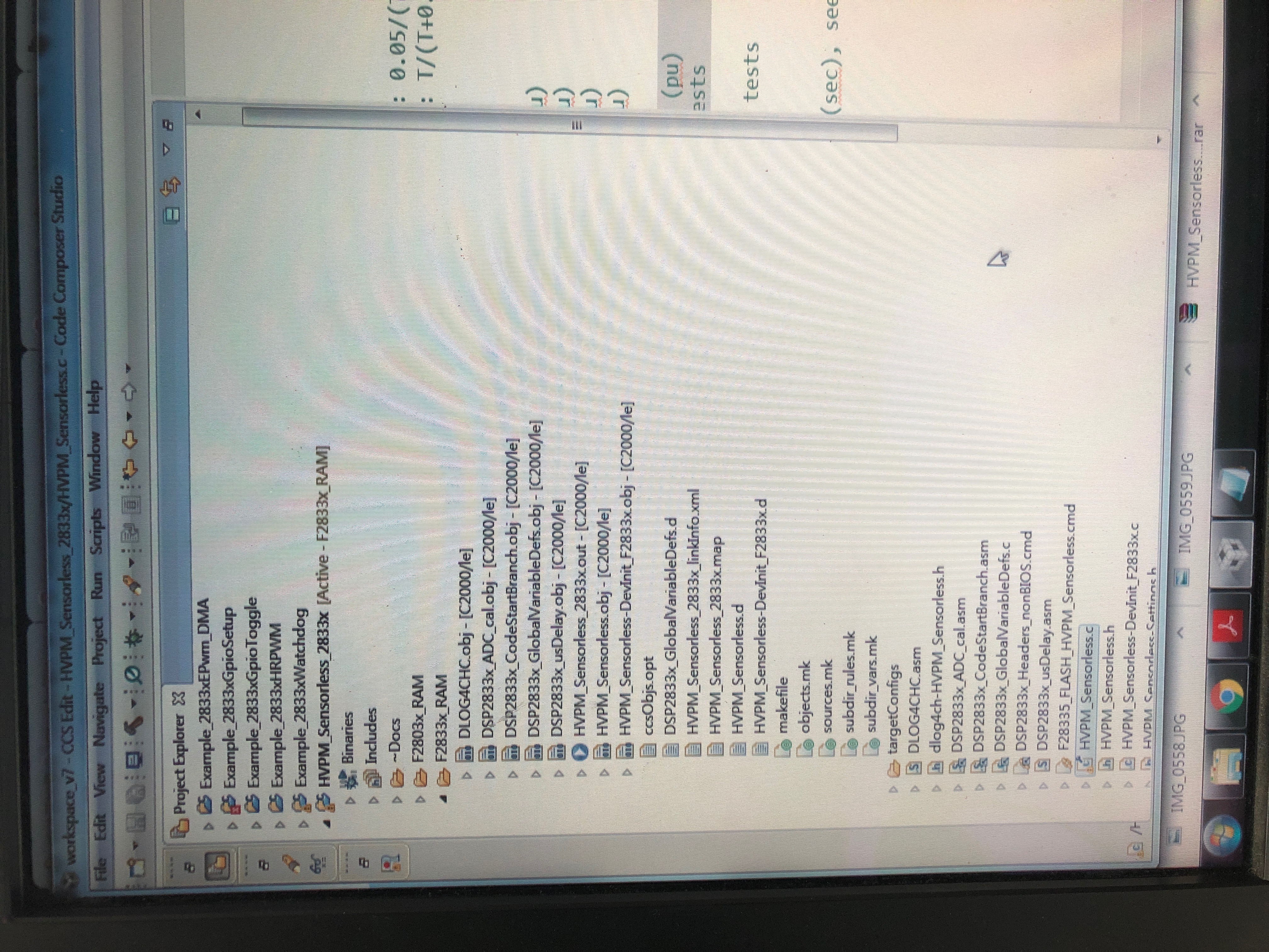

  • Can you look in the Debug sub-directory of the project and confirm there is a .out file present from the build operation?
    If there is I would try to connect to the MCU target first, then under "Run" do a manual program load.  I'd like to take the automation that clicking the "debug" icon is giving.
