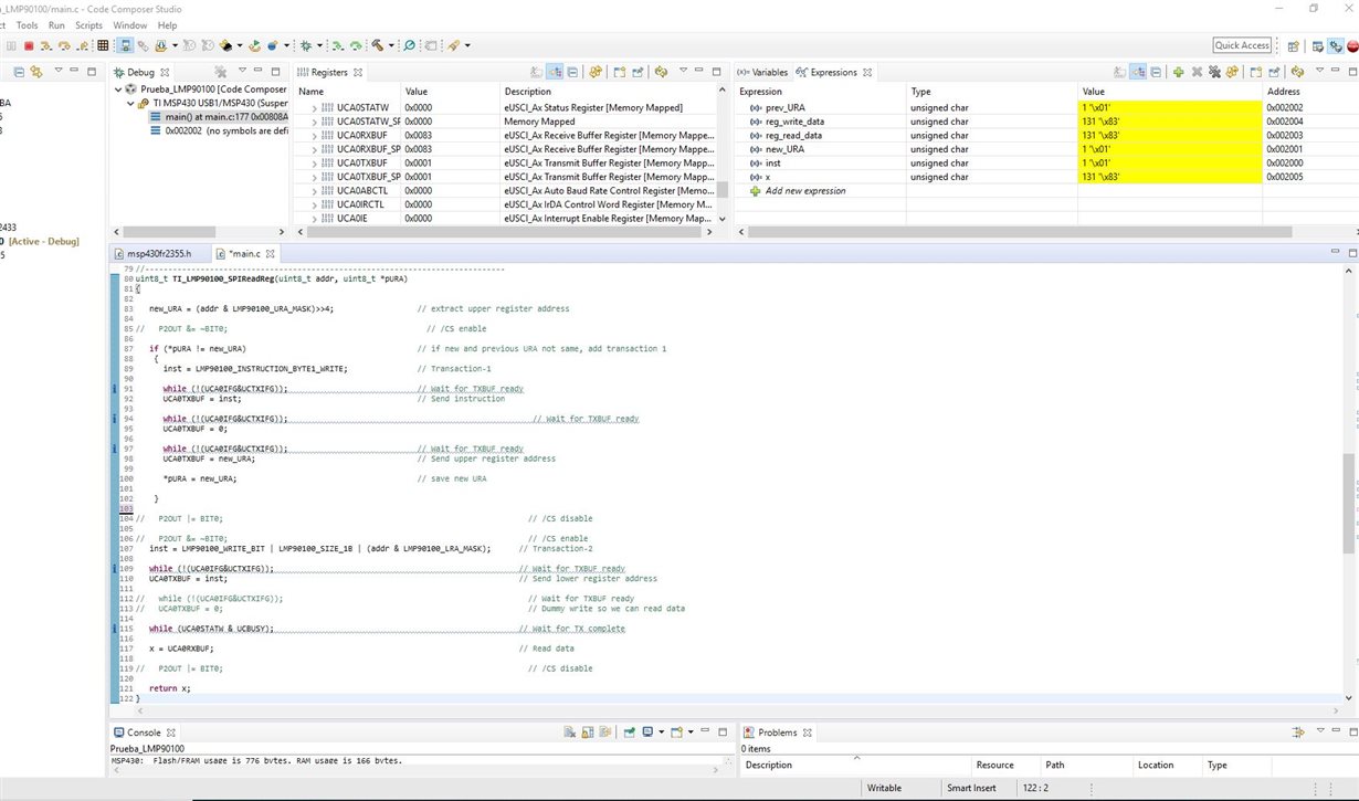

Hi everyone,
Could someone please help me?
I want to connect MSP430FR2355 with LMP90100 by SPI interface using the "Demo Application01 for MSP430/LMP90100 Interface Code Library v1.0" code. I'm trying to write 0x83 value to 0x11 register but MISO returns 0x00 all the time. I know that I'm missing something but I don't know what it is.
Connections:  3.3V -------------------------------> VDD3P3 (JP12.13)
                       GND ------------------------------> GND (JP12.2)
                       GND ------------------------------> GND (J8)
                       UCA0CLK (P1.5) --------------> SCLK (J8)
                       UCA0SOMI (P1.6) ------------> SDO_DRDYB (J8)
                       UCA0SIMO (P1.7) ------------> SDI (J8)
                       CS (P2.0) ------------------------> CSB (J8)
                       P2.2 -------------------------------> D6_DRDYB (JP8)

  • The data sheet (SNSAS510S) Sec. 9.5.6 says Transactions are framed by CSB transitions, and Sec. 9.5.4 refers to INST1 and INST2 as separate Transactions. Have you tried wiggling CSB around each of those separately?
    Unsolicited: Since you're driving CSB as a GPIO, you're really doing 3-wire (UCMODE=0, UCSTEM=0). Even if you connected UCASTE (P1SEL), UCSTEM=1 wouldn't do what you want. I suggest you use UCMODE_0 with UCSTEM=0; I can't say that it's causing trouble, but it might be prudent anyway.
  • Sorry, what do you mean with "Have you tried wiggling CSB around each of those separately"?
    Okay I will try with UCMODE_0 with UCSTEM=0. Thank you for the advice!
  • Do you mean something like this?
    void TI_LMP90100_SPIWriteReg(uint8_t addr, uint8_t value, uint8_t *pURA)
    uint8_t new_URA, inst;
    new_URA = (addr & LMP90100_URA_MASK)>>4; // extract upper register address
    P2OUT &= ~BIT0; // /CS enable
    if (*pURA != new_URA) // if new and previous URA not same, add transaction 1
    inst = LMP90100_INSTRUCTION_BYTE1_WRITE; // Transaction-1
    while (!(UCA0IFG&UCTXIFG)); // Wait for TXBUF ready
    UCA0TXBUF = inst; // Send instruction
    UCA0TXBUF = new_URA; // Send upper register address
    *pURA = new_URA; // save new URA
    P2OUT |= BIT0; // /CS disable <---------------------- THIS
    P2OUT &= ~BIT0; // /CS enable <---------------------- AND THIS
    inst = LMP90100_WRITE_BIT | LMP90100_SIZE_1B |(addr & LMP90100_LRA_MASK); // lower register address
    UCA0TXBUF = inst; // Send lower register address
    UCA0TXBUF = value; // Send data value
    while (UCA0STATW & UCBUSY); // Wait for TX complete
  • Hi, I just resolved the problem summing dummy byte after write instructions and also removing dummy after transaction 2.
    // while (!(UCA0IFG&UCTXIFG)); // Wait for TXBUF ready
    // UCA0TXBUF = 0; // Dummy write so we can read data
    x = UCA0RXBUF; // Read data
    // P2OUT |= BIT0; // /CS disable
    return x;
    Mikel
  • Evidently CSB isn't needed at all. (That Wasn't going to be my next guess (:-)).) I'm glad you got it working.
  • Hi Bruce,
    It worked for a moment, but I'm stuck again hahaha.
    Edited:
    Well, sometimes it works and sometimes it does not. I don't know why, it's turning me crazy hahaha.
  • It seems like sometimes the UCA0RXBUF doesn't receive 0x83 value. Why could this be happening?
  • As I read data sheet (SNAS510S) Fig 60, Transaction-1 (INST1) is only two bytes, but you're sending three bytes. I suspect the third byte is being interpreted as the first byte of Transaction-2.
    Similarly, I don't see how you'll get the read-data byte from Transaction-2 without sending a dummy byte. I suspect you sometimes get the right thing "by accident" due to the mis-count in Transaction-1.
  • I tried exactly with the same configuration as the datasheet but it didn't work. That's why I changed the code on both transactions. Now I'm trying different configurations and also changing "LMP90100_SIZE_1B" with "LMP90100_SIZE_2B" or "LMP90100_SIZE_3B". I'm getting some different values in reg_read_data but are not correct. Let's see if I get the correct configuration.
