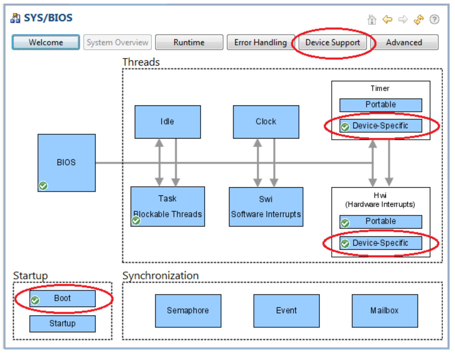

  • General Considerations for Using SYS/BIOS with 28x
    The following shows most SYS/BIOS configuration settings using *.cfg source code snippets. You can also configure 28x applications using the XGCONF Graphical Configuration Tool. For example, when you open the tool, you see the Welcome screen. You can click the System Overview button to see a block diagram of the available SYS/BIOS modules. Modules used by your application have a green checkmark. Notice the modules circled in red in the following figure; they have configuration settings that are specific to 28x devices.

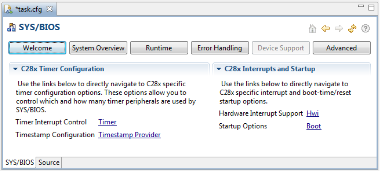

    If you click the Device Support button at the top of the XGCONF page, you see a list of SYS/BIOS modules that apply to the 28x. You can click those links to see a configuration page for each module.

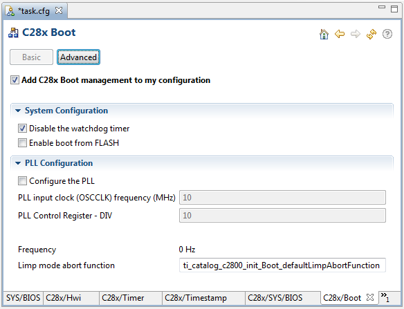

    Booting SYS/BIOS Application on 28x
    First, please look at the general boot for a device with TI-RTOS: https://e2e.ti.com/support/processors/f/791/p/953161/3521880.
    For 28x devices, SYS/BIOS installs a configurable Startup reset function called ti_catalog_c2800_init_Boot_init(), which is provided by XDCtools. Depending on your configuration of the ti.catalog.c2800.init.Boot module, this function performs the following actions:
    • Disables the watchdog timer
    • Configures the PLL
    • Sets the CPU frequency to the one you have configured
    • For eZdsp283xx boards only, configures the XINTF external memory interface

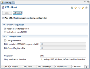

    You can configure what the Startup reset function does using the C28x Boot module. First, in XGCONF select the Boot module from the SYS/BIOS System Overview page:
    You will see the configuration page for the 28x Boot module.
    Watchdog timer: By default, the watchdog timer is enabled, meaning that if the system hangs long enough for the watchdog timer's 8-bit counter to reach its maximum value, a system reset is triggered. To prevent this, you can check the "Disable the watchdog timer" box in XGCONF or use the following configuration statements:
    var Boot = xdc.useModule('ti.catalog.c2800.init.Boot');
    Boot.disableWatchdog = true;
    Boot from Flash: If you want to be able to boot this application from Flash, check the "Enable boot from FLASH" box in XGCONF or use the following configuration statements:
    Boot.bootFromFlash = true;
    If you configure your application to boot from Flash, a long branch (LB) to the c_int00 entry point will be placed at the BEGIN section address defined in the linker command file.
    PLL configuration: The phase-locked loop (PLL) on 28x devices is used to maintain correct clocking rates.
    Note: On 280x and 281x devices, XDCtools and SYS/BIOS do not configure the PLL. The PLL is in its default state--bypassed but not turned off--after your application finished booting. If you want to modify the configuration of the PLL on these devices, you can add a Reset function as described at this end of this step (2).
    By default, XDCtools automatically enables the PLL for your 2802x, 2803x, 2806x, 282xx, 283xx, or 2834x device. If you want to override the default PLL configuration, you can check the "Configure the PLL" box in XGCONF and set values for the following parameters:
    • PLL input clock (OSCCLK) frequency (MHz) sets the frequency of the oscillator clock (OSCCLK) input to the PLL. On some devices (for example, the TMS320C28346) this corresponds to the frequency of an external crystal or clock input. On others (for example, the TMS320F28069) this corresponds to the frequency of an internal oscillator which is the default OSCCLK coming out of reset.
    • PLL Control Register - DIV specifies the PLL clocking ratio value. This value is the actual value written to the DIV bits in the PLL Control Register (PLLCR[DIV]). This value controls whether the PLL is bypassed or not and sets the PLL clocking ratio when it is not bypassed. The default value is 10.
    • PLL Status Register - DIVSEL specifies the PLL divide select value. This value is the actual value written to the DIVSEL bits in the PLL Status Register (PLLSTS[DIVSEL]). The default value is 2. To divide by 4, use a value of 0 or 1.
    • Limp mode abort function specifies a function to be called if the Boot module finds the device operating in Limp mode (that is, if the OSCCLK input is missing). The default function provided by XDCtools does an ESTOP0 and then enters an infinite loop.
    • Frequency shows the resulting PLL frequency in Hz based on your current configuration. The calculation is Boot.pllOSCCLK * Boot.pllcrDIV * 1000000) / divider, where divider is 2 if Boot.pllstsDIVSEL is 2 and 4 if Boot.pllstsDIVSEL is 0 or 1.
    For example, the following configuration statements configure the PLL to a slower rate.
    Boot.configurePll = true;
    Boot.pllOSCCLK = 8;
    Boot.pllcrDIV = 2;
    Boot.pllstsDIVSEL = 0;
    User-defined reset functions: If you want to add your own functions to the table of early reset functions, you can do so by adding statements like the following to your application configuration file:
    Reset = xdc.useModule('xdc.runtime.Reset');
    Reset.fxns[Reset.fxns.length++] = '&myResetFxn';

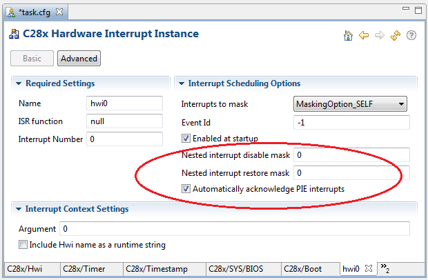

    The following additional configuration parameters are provided for configuring 28x interrupts:
    • Hwi.enableAck enables automatic clearing of the CPU acknowledge bit for PIE interrupts by the SYS/BIOS interrupt dispatcher. This must be done before further interrupts from that block can occur. By default, SYS/BIOS does this for you. See Plugging Interrupts for Use Outside the SYS/BIOS Interrupt Dispatcher for more about clearing this bit.
    • Hwi.disableMask defines which IER bits are disabled prior to invoking an ISR function. This mask is used only if the SYS/BIOS interrupt dispatcher is set to support nested hardware interrupts (the default, set by the Hwi.dispatcherAutoNestingSupport property) and you set the maskSetting parameter for a Hwi object to MaskingOption_BITMASK. Bits in this mask set to 1 correspond to IER bits that will be cleared prior to invoking the ISR.
    • Hwi.restoreMask defines which IER bits are restored to their previous setting upon returning from an ISR function. This mask is used only if the SYS/BIOS interrupt dispatcher is set to support nested hardware interrupts (the default, set by the Hwi.dispatcherAutoNestingSupport property) and you set the maskSetting parameter for a Hwi object to MaskingOption_BITMASK. Bits in this mask set to 1 correspond to IER bits that will be restored.

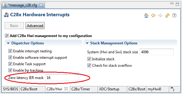

    Minimal Latency Interrupts
    You can pass a bitmask to the Hwi.zeroLatencyIERMask property to identify interrupts that should never be disabled. The advantage to doing this is that such interrupts will have minimal interrupt-to-ISR execution time. (Though the property name is named "zero latency", the latency is actually minimized, but not zero.) The disadvantage to using this setting is that when SYS/BIOS disables or enabling interrupts, extra work is required to avoid making changes to such interrupts.
    For example, the following configuration code sets INT5 and the PIE group 5 multiplexed to INT5 to provide minimal latency:
    var Hwi = xdc.useModule('ti.sysbios.family.c28.Hwi');
    Hwi.zeroLatencyIERMask = 0x0010;
    Bit 0 in the IER mask corresponds to INT1 and PIE group 1. Bit 1 corresponds to INT2 and PIE group 2, and so on through INT12. Bits 12-16 are used for other purposes, and should not be set in the zeroLatencyIERMask. In the previous example, a mask of 0x0010 sets bit 4, which corresponds to INT5.
    By default, the Hwi.zeroLatencyIERMask property is shown as a decimal value in XGCONF:
    Note that all the interrupts in the PIE group whose bit is set in the zeroLatencyIERMask will be treated as zero latency interrupts.
    Note: We recommend that you use the zeroLatencyIERMask only if all interrupts in the groups execute non-SYS/BIOS interrupt handlers. This feature is best used only in applications that demand very low latency.
    CPU interrupts specified in this mask (which corresponds to the 16-bit IER register) are not disabled by the Hwi_disable() call and are generally left enabled except when explicitly disabled using Hwi_disableIER() or Hwi_disablePIEIER().
    If you use zero latency mode for any interrupt, the code used to disable, enable, and restore interrupts in SYS/BIOS will be slower. This is because the code needs to set individual bits in the IER register rather than setting the INTM bit. It is important to be aware of the performance tradeoff associated with using zero latency interrupts before using this feature.

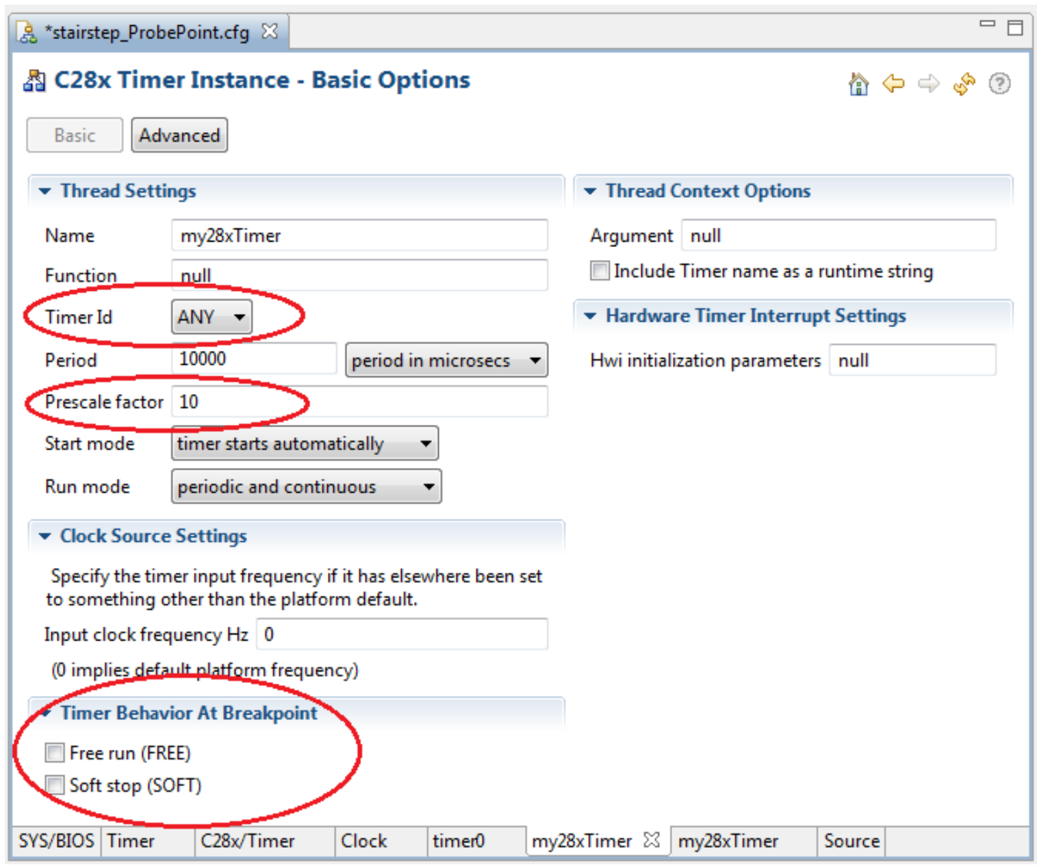

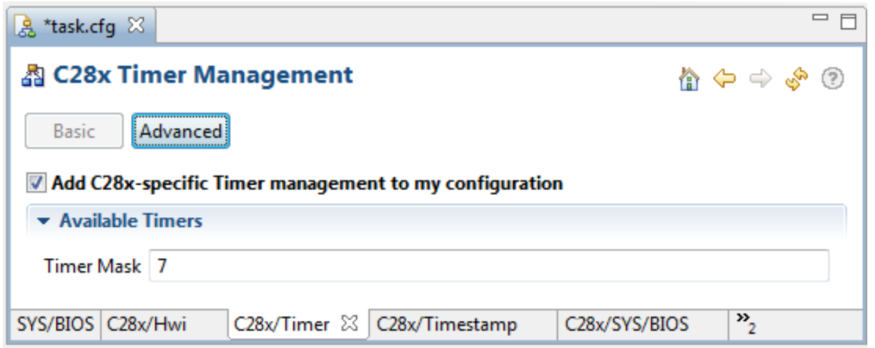

    28x Timer Management with SYS/BIOS
    The 28x devices have three 32-bit timers--Timer 0 through Timer 2. By default, SYS/BIOS uses two of these timers, one for the Clock module and one for the Timestamp module. Typically, the timers used by SYS/BIOS are Timer 0 and Timer 1, but if your application uses a timer for its own processing, SYS/BIOS will use Timer 2 if necessary.

    Timer
    Internally, the 28x timers count downward from "period" to 0; however, the Timer_getCount() API subtracts the timer counter value from the period so that it counts upward instead of downward.
    The ti.sysbios.family.c28.Timer module configuration lets you specify a mask to identify the CPU timers that are available for use by the Timer module. By default, this mask is set to 7 (111 in binary), which means that Timers 0, 1, and 2 are available. Timers used by SYS/BIOS need not be omitted from this mask, but if your application uses a specific 28x timer, you should omit the bit for that timer from this mask.
    If you create an instance of the device-specific ti.sysbios.family.c28.Timer module (rather than an instance of the generic ti.sysbios.hal.Timer module), you can also configure the 28x parameters circled below:
    The Timer Id parameter specifies which 28x CPU timer should be used for this instance. If you choose ANY, the first available timer is used. Remember that 28x devices have 3 timers and SYS/BIOS uses 2 by default.
    The Prescale factor parameter sets the length of a timer tick using the 28x device's 16-bit prescaler. If a prescale factor of 10 is specified, a timer tick will occur every 11 cycles. If this timer is used as a counter, the prescale factor determines the period between counts. Otherwise, the prescale factor can be used to achieve longer timer periods; with a prescale specified, the actual period is period * prescale+1
    The 28x Timer module provides the following APIs to access the prescaler:
    • Timer_getPrescale() Returns the prescale configuration setting.
    • Timer_getPrescaleCount() returns the current counter value for the prescaler
    • Timer_setPrescale() Sets the prescale configuration to a new value. This has the effect of changing the timer's actual period.
    The Free run and Soft stop parameters let you specify how a timer behaves at a software breakpoint, like those you can set in Code Composer Studio. If the "free" flag is set to 1, the timer will continue to run normally when the program halts at a software breakpoint; the value of the "soft" flag doesn't matter if "free" is set to 1. If "free" is 0 and "soft" is 1, the timer will run down to 0 and then stop. When "free" is 0 and "soft" is 0 (the default), the timer halts at software breakpoints.
    For example, the following configuration code creates a 28x Timer with a period of 2000 microseconds and a prescale value of 999. As a result, the Timer ticks every 1000 cycles (prescale+1) and the actual period for running the myTimerFxn() function is 2,000,000 microseconds (2 seconds). When a software breakpoint occurs in Code Composer Studio, this Timer will continue to run.
    var ti_sysbios_family_c28_Timer = xdc.useModule('ti.sysbios.family.c28.Timer');
    var my28xTimerParams = new ti_sysbios_family_c28_Timer.Params();
    my28xTimerParams.instance.name = "my28xTimer";
    my28xTimerParams.period = 2000;
    my28xTimerParams.prescale = 999;
    my28xTimerParams.emulationModeInit.free = 1;
    my28xTimerParams.emulationModeInit.soft = 0;
    Program.global.my28xTimer = ti_sysbios_family_c28_Timer.create(null, "&myTimerFxn", my28xTimerParams);
    As with other device-specific Timer modules, you can also specify the creation parameters for the Hwi object to be triggered by this timer interrupt.

    The System stack and all Task stacks must be located within Page 0 in memory, which has a memory address of 0 to 0xffff. An error is raised if a Task stack is placed in some other memory location. By default, Task stacks are placed in the .ebss:taskStackSection section, which is on Page 0. This section is a subsection of .ebss to allow SYS/BIOS to be used with the CCS-supplied linker .cmd files for the 28x devices.
    The .taskStackSection contains the stacks for statically created tasks. The size of the .taskStackSection is calculated as (Task.defaultStackSize * number of static tasks) + system heap size.
    To reduce the size of this section, you can do the following:
    1. By default, the Task.defaultStackSize is 256 (0x100) 16-bit words. You can configure this value to be somewhat smaller in the Task module parameter settings.
    2. Minimize number of tasks in your application.
    3. Minimize the size of the heap for dynamic allocations (HeapMem.heapMemParams.size) or eliminate all dynamic memory allocation by configuring objects statically.
    As you decrease heap and stack sizes, you'll need to watch for "out of memory" errors from heaps and overrunning your stacks. The ROV tool can be helpful in monitoring stack and heap usage.
