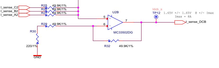

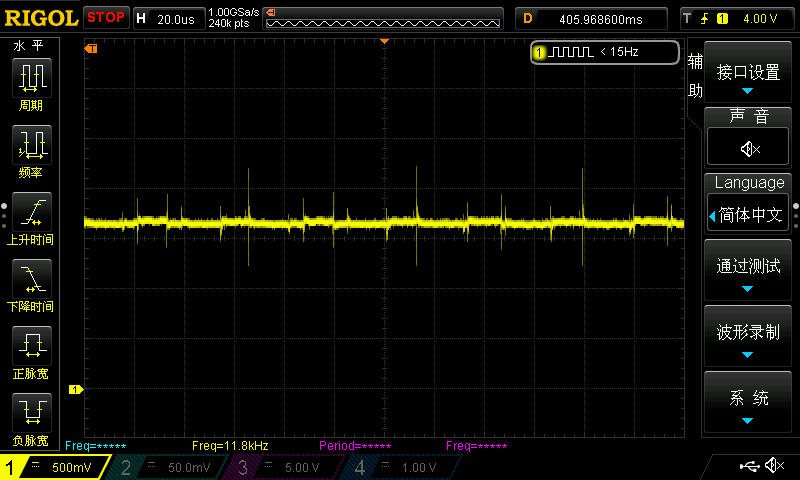

  • hello Dave,
    would you please explain the first solution to get current buss more clearly?
    i have used OP-AMP of TI sch to add 3-phase voltage,but the out of OP-AMP is almost zero.
    what is the correct way to add 3-phase voltage?
    op-amp circuit and it's output diagram attached:
  • Even, please make a new thread for any questions you may have, as we prefer not to work on threads that are this old.
