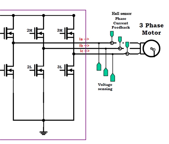

I do my board according to DRV8301-69M-KIT.The only difference is that I use hall sensor  for current sampling.As shown.The measuring range of hall sensor is ± 833.33A.
Now I encounter some problems.The parameters of my BLDC motor can be identified well on DRV8301-69M-KIT,but something unusual happened on my board.The motor produce a strong shock and a harsh noise in lab02a.
As I know, the current(100Hz) is injected in order to calculate current controller gains in lab02a.So I see waveform of this current.I was shocked the current was too large... As shown
Current frequency is 100Hz,but peak-to-peak value = 74A. I do not know the reason.

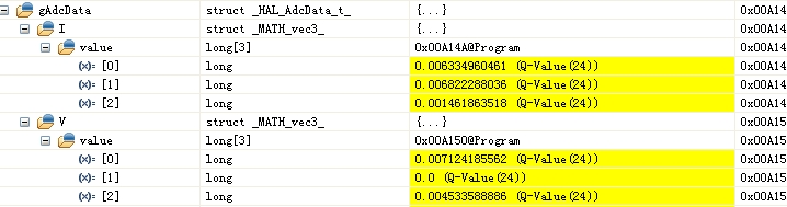

  • Now I run lab01 to check ADC pins.
    EXT_IA_IB  voltage value = 1.657V
    EXT_IB_IB  voltage value = 1.657V
    EXT_IC_IB  voltage value = 1.660V
    I checked the value of gAdcData,as shown
    Is all this case above about ADC normal?
    whether software program of MotorWare is fit for sampling phase current?
  • I think your current sense HW is incorrect
  • Thanks for Chris reply.
    My hall sense is MLX91205. Resolution is 3mV/A.
    See my post before:
    http://e2e.ti.com/support/microcontrollers/c2000/f/902/p/335807/1246504.aspx#1246504
    Do you think there is the wrong design concept about peripheral hardware circuit of opa2365?
  • Could you swap the polarity of your current sensor? It sounds like a inverse polarity and the current controllers generating maximum voltage trying to compensate a current that grows negative.
  • Thanks Jorge
    I will try to change the polarity of my current sensor to see what will happen and reply here tomorrow.
  • Thanks very much,Chris and Jorge.You are right.
    The polarity of my current sensor is incorrect.Now I have resolved the problem with your help.
