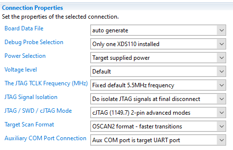

    Thank you for the inputs:
    Few things to note:
    1. I used a short length cable and it seems to improve the situation but not solve it.
    2. I also updated the emulation drivers to latest one which did not help either.
    3. Here are my configuration settings: any idea or changes here that can help?
    Conisdering the sample rate of the model 200Khz I need to run at the max baud rate.

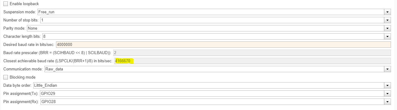

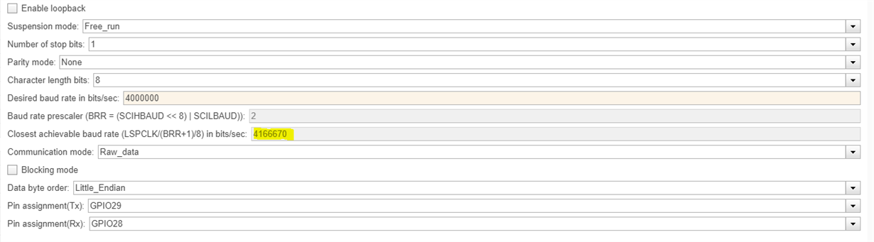

    However I tried to run at lower baud rate like 4Mbps which is still acceptable, but I cannot establish the host and target connection.
    Not sure why? It seems we cannot achieve exactly 4Mbps on the target, but I tried to program the host model to the baud rate which target is running at:

    The XDS110 configuration you sent is sensible and I don't see any issues with it. All things considered, I suspect the very high bps rate of the UART port is causing the instability/malfunction, thus a few additional considerations to the otherwise good points already made:
    - If you are concurrently running the UART and a Debug Session, the USB channel of the XDS110 may be getting clogged by the high traffic. I would perhaps close the Debug Session (or reduce its throughput by closing memory, graph, disassembly views, real-time update of variables, registers, etc.)
    - The LAUNCHXL-F280049C uses USB isolation devices between the board and the USB channel - that has the potential to reduce the available throughput. If you have a separate USB-Serial interface available with you (such as the TTL-232RG-VSW3V3-WE cable) and connect to the device pins directly on your board, this will offload the throughput on the XDS110. Bonus points if you connect it directly to your host and not through the same Hub the XDS110 is connected (if you are doing such configuration).
    I am not sure why the Matlab's configurations do not match an exact 4Mbps, but it may be due to the device itself and I will have to defer to the C2000 experts. At this point I don't have anything to add with regards to the tool itself.
