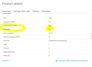

Hello everyone,
with Lori Heustess I managed to save program in flash either for non BIOS and BIOS projects (https://e2e.ti.com/support/microcontrollers/c2000/f/c2000-microcontrollers-forum/984757/launchxl-f28027f-can-t-boot-program-from-flash/36431100)
But now I have another odd problem. I wrote simple program in which there is an echo on UART. It works when I am debugging it by CCS but when I run it from flash only timer task works - I can see it by toggled LEDs. It seems that SCI interrupts are not fired. I put  line that toggles LEDs in interrupt handlers and there was not any action. I have no idea what can cause that behaviour - as I wrote, timer handler works and LEDs are toggled in it. Here are files: main.c, app.cfg and TMS320F28027.cmd:

MEMORY
PAGE 0:    /* Program Memory */
    OTP         : origin = 0x3D7800, length = 0x000400     /* on-chip OTP */
    FLASH       : origin = 0x3F0000, length = 0x007F80     /* on-chip FLASH */
    CSM_RSVD    : origin = 0x3F7F80, length = 0x000076     /* Program with all 0x0000 when CSM is in use. */
    BEGIN       : origin = 0x3F7FF6, length = 0x000002     /* Used for "boot to Flash" bootloader mode. */
    CSM_PWL     : origin = 0x3F7FF8, length = 0x000008     /* CSM password locations in FLASH */
    IQTABLES    : origin = 0x3FE000, length = 0x000B50     /* IQ Math Tables in Boot ROM */
    IQTABLES2   : origin = 0x3FEB50, length = 0x00008C     /* IQ Math Tables in Boot ROM */
    IQTABLES3   : origin = 0x3FEBDC, length = 0x0000AA	   /* IQ Math Tables in Boot ROM */
    ROM         : origin = 0x3FF27C, length = 0x000D44     /* Boot ROM */
    RESET       : origin = 0x3FFFC0, length = 0x000002     /* part of boot ROM  */
    VECTORS     : origin = 0x3FFFC2, length = 0x00003E     /* part of boot ROM  */
PAGE 1 :   /* Data Memory */
    M01SARAM    : origin = 0x000000, length = 0x000800     /* on-chip RAM block M0, M1 */
    PIEVECT     : origin = 0xD00,    length = 0x100
    L0SARAM     : origin = 0x008000, length = 0x001000     /* on-chip RAM block L0 */

    And I noticed another interesting fact - TMS320F280027F should have 16k RAM and 32k FLASH (https://www.ti.com/product/TMS320F28027F#product-details##params):
    Look at my memory allocation diagram:
    I can allocate ca. 2x less than available. Linker file I use is default from new project created. It's a lot and I think it shouldn't be such a difference. I took a look in reference manual and there is what I found:
    When we add L0 SARAM, M0 SARAM and M1 SARAM we'll get 10 k RAM.
    Another fact - in my cmd file there wasn't declared L0 SARAM from 0x3F 8000. I added it and I tried to place there ramfunc. Program started but when I typed character in terminal program crashed. Where I can find missing part of RAM and FLASH?
  • I can allocate ca. 2x less than available.
    The confusion is that the CCS Memory Allocation view displays the memory usage in terms of 16-bit words, but labels the values as "x out of y bytes used". Where "bytes" is normally taken to be a count of 8-bit units. See CCS/TMS320F280049: CCS memory allocation view unit used for C2000. I.e. believe the Memory Allocation is showing all of the device memory.
  • Chester is correct.  The C28x smallest addressable unit is a 16-bit word so our tools work with this unit.  For some marketing material the bytes are listed to help customers compare memory sizes with other devices.
  • Another fact - in my cmd file there wasn't declared L0 SARAM from 0x3F 8000. I added it and I tried to place there ramfunc.
    If your linker has L0 at 0x8000 then this is the same physical memory block.  Use one or the other in the linker command file, but not both.  If you tell the tools both exist then you will likely write over something allocated to the other block.
