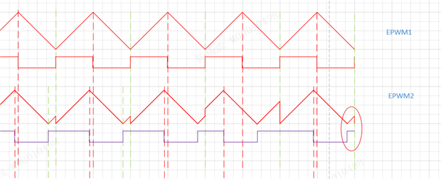

  • hi:
        Yes.My backgroud change the period.when frequency low (high TBPRD ) to low fraquency(low TBPRD) has similar result.

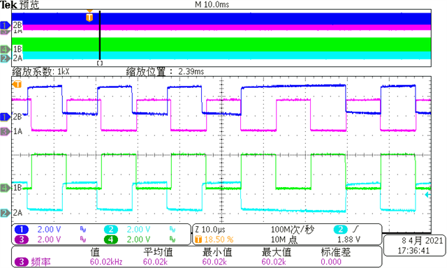

        after Test,I find some issue:
        EPWM2 configuration change to :
        EPWM_setTimeBasePeriod(EPWM2_BASE, DCDC_PSFB_PRD_NOR - 1);
        1. when Phase value change to 0, EPWM2 lost a period.
        lead :
        channel 3: EPWM1A
        channel 4: EPWM1B
        lag:
        channel 1: EPWM2B
        channel 2: EPWM2A
       accord to techinical reference, should not appear that issue.
    can you kwon the reason and how to resolve it
    What you are showing is not period being lost. It is the expected behavior. Since you are loading the phase to zero, it'll abruptly change the counter value and that could result in missing the compare events for that cycle. You have to expect such behavior when you change the period/phase abruptly.

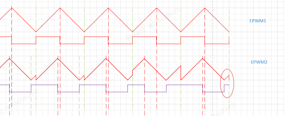

         1.as TBPRD of EPWM2 < EPWM1,before EPWM1 conter is to 0,the counter of EPWM2 is  to 0 ,so the ZERO events should be action.
         PLS see following logic.

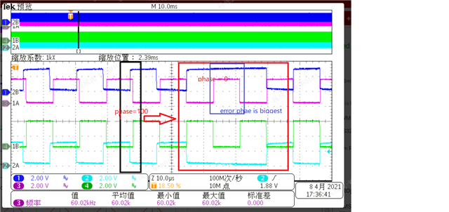

    2. what's period/phase abruptly means, if anyvalue change to  0 is abruptly change?
    oscilloscope picture show is phase just  100 to 0.
    Yes - I would expect the Zero action to take effect - if you are loading a phase value of Zero. What action did you define for zero?
    If it's PWM set high, then PWM is already high - hence it's of no consequence. It seems, what is missed is the CMPA event in the waveform.
    Is that correct?
    You need to make sure that the CMPA event is not missed (load CMPA value accordingly) as you know upfront the value of the phase you are loading and counter value.
  • HI :
    Is that correct?
             seem to zero event is not active.
             I want to EPWM2A is high when counter is zero,the same time EPWM2B is low.
             EPWM_setActionQualifierAction(EPWM2_BASE, EPWM_AQ_OUTPUT_A ,EPWM_AQ_OUTPUT_HIGH, EPWM_AQ_OUTPUT_ON_TIMEBASE_ZERO);
    EPWM_setActionQualifierAction(EPWM2_BASE, EPWM_AQ_OUTPUT_A ,EPWM_AQ_OUTPUT_LOW, EPWM_AQ_OUTPUT_ON_TIMEBASE_PERIOD);
             but the result is when  phase = 0, EPWM2A  is low and EPWM2B is high.this is a big problem.
        channel 3: EPWM1A
        channel 4: EPWM1B
        channel 1: EPWM2B
        channel 2: EPWM2A
    Yes, I would expect counter zero event to take effect. Because you are loading a phase of zero.
