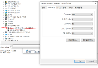

  • After closing J3 and configuring SCI boot, I checked the COM port settings.
    As shown in the attached image, the settings are as described in the manual.

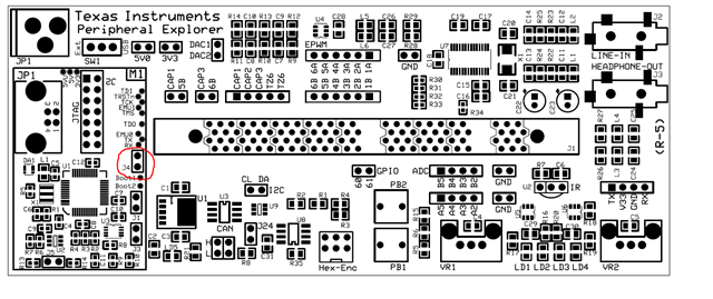

    I looked at the schematic again, can you confirm that you are placing a jumper on J4 as shown in the attachment?  This is needed to connect the Rx signal to M1.  If you place the J4, try to see if the Windows HW manager detects the UART via the USB connection as we talked before.
    Matthew
  • Until now, I didn't make J4 jump.
    I jumped J4 as instructed and ran Echoback.c again. But the result was the same (I'm stuck in a while loop with XRDY = 1)
    Is it possible to confirm the UART detection on the attached device manager screen? I'm not sure how I can say I'm connected ...
  • Enomoto,
    Thank you for the image, the PC is still not seeing the COM port.  I believe this is an issue with how the FTDI device is programmed to be XDS100v1.
    I have attached a ZIP file that has the programmer application "MPROG" along with a new file to add UART backchannel.  Please extract and follow the below instructions:

  • hi, Matthew
    Thanks for the detailed steps.
    MProg.exe has been executed.
    "Programmed Serial Number ..." doesn't match Mr. Matthew's, is that a problem?
    When I check the device manager, the display is different from the previous one. Can this take me to the next step?
  • Enomoto,
    Its not an issue if the serial number is different, that is OK.  Yes, please try to use the COM6 and see if this will communicate via UART.
    If this does not work, please take a look at this post, regarding a potential fix for a bad driver. https://e2e.ti.com/support/tools/code-composer-studio-group/ccs/f/code-composer-studio-forum/522774/xds100v1-and-xds100v2-driver-problem
    Matthew

  • Enomoto,
    Yes, for some reason the host PC is not recognizing the UART channel on the FTDI device.  I'm assuming this is still caused by some driver issue, but that may be challenging to debug over the E2E.
    Let's remove J4 and attempt to use the single pin header with TX/V33/GND/RX you see at the bottom of the PREX board.  Are you able to manually connect thee TX/RX/GND signals to the DB9 header on your PC?
    Matthew
