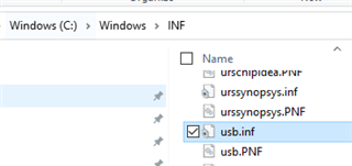

I attempted to install the latest CCS emulation tools to 6.0.228.0 and now the XDS100v1/v2 devices are no longer detected by windows.  I can manually install the drivers using "Have Disk" -> Point them to "C:\ti\ccsv6\ccs_base\emulation\windows\xds100_drivers\ftdi" but the device is only recognizes as TI XDS100 Channel A.  I cannot seem to get the device to load both channels.  So far I have:
Uninstalled all TI and FTDI drivers.  Through windows control panel and through pnputil.exe
Reinstalled FTDI drivers from FTDI's website.
Reinstalled the emulation package.
Manually install the drivers through DPInst64.exe /SA /PATH "C:\ti\ccsv6/ccs_base/emulation/windows/xds100_drivers/ftdi"
Manually remove c:\windows\system32 > FTID dlls.
Reinstall all again.
And yet still windows does not automatically find the drivers.
I have also used FTProg to reinstall the firmware on the FTDI chips in the eval kits.  Still to no avail.
I am using with the Concerto  F28M36x Control Card and the F28335 Control Card on the Docking Station.
These evaluation kits work fine on another computer without issue.
