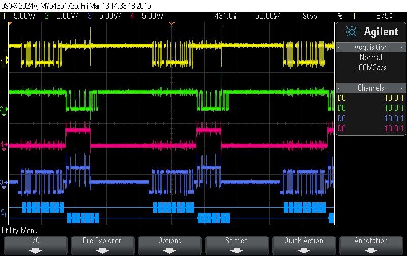

I'm using a TMS570LS3137 and SafeRTOS to receive and transmit datagrams via SCI and RS485 with aid of DMA. Therefore, I wait for the DMA block transfer complete interrupts to toggle the transmit enable line of the transceiver. So, there's a bidirectional communication via half-duplex RS485. This works fine for reception. But with transmission I get the DMA BTC interrupt two bytes too early.
Please find attached an oscilloscope screenshot: Yellow is Rx, green is Tx, red is the transceiver transmit enable line, and blue is the resulting RS485 bus signal. Since the DMA transmit BTC interrupt is triggered too early, transmitted datagrams are cut off. I could verify that the transceiver transmit enable signal (red) goes to low at the moment when the DMA transmit BTC interrupt is triggered. I've also attached the DMA init function, the SCI init function and a schematic representation of the DMA interrupt service routine. Please ignore the burst on Rx and Tx when the transceiver transmit enable line goes to low.
Do you have any idea what is going wrong?
Thank you in advance!
Andre
