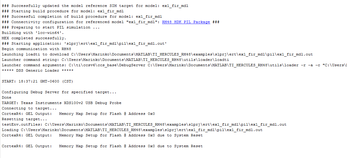

I need some help getting the TMS570 to work with Matlab 2015a. I have done all the steps listed here TI Hercules PIL Target for RM48
After contacting Anthony Seely the author of the toolbox, I was able to get rid of some of the errors that were coming up. Now I am having an issue when I try to run the sample simulation my matlab keeps on getting stuck and unresponsive.
Here is the image of the last command where this happens.

  • Hi Marinko,
    I have not looked at the upload attached to this post yet - but i looked yesterday at what you sent privately to me and I thought that the issue was that you had left out the '--be32' switch from the 'linkerOpts' cell array. Thought I sent you an email response on this. If not my apologies.
    If so please let me know if you tried adding the '--be32' and if that worked or not.
    I was able to download the .out file that was built for the target in the slprj folder into the device, but it is loaded into memory byte swapped (likely because the linker --be32 option is missing) therefore the code does not run to main and halt there which I think the script expects. Instead it gets stuck at the undef exception vector.
