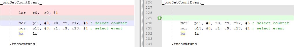

I'm using the PMU module of the RM48 on HDK REV - D & E with halcogen.
With Halcogen 04.05.01, in the file sys_pmu.asm the first line of code is missing for _pmuSetCountEvent_ and _pmuGetEventCount_ function
Yours,
Martin V.
In the thread Errors in setting the Performance Counter Selection Register in HALCoGen 04.03.00? I suggested removing the initial lsr instruction which left-shifts the counter parameter by one bit before writing to the Performance Counter Selection Register, since the instruction meant the _pmuSetCountEvent_ and _pmuGetEventCount_ functions didn't operate as expected.Vanderwegen Martin said:With Halcogen 04.05.01, in the file sys_pmu.asm the first line of code is missing for _pmuSetCountEvent_ and _pmuGetEventCount_ function
With Halcogen 04.05.01 the contents of the sys_pmu.asm file matches my suggested changes in the referenced thread.
My concern is that my suggested code change has broken some existing applications. Could someone from TI comment.
