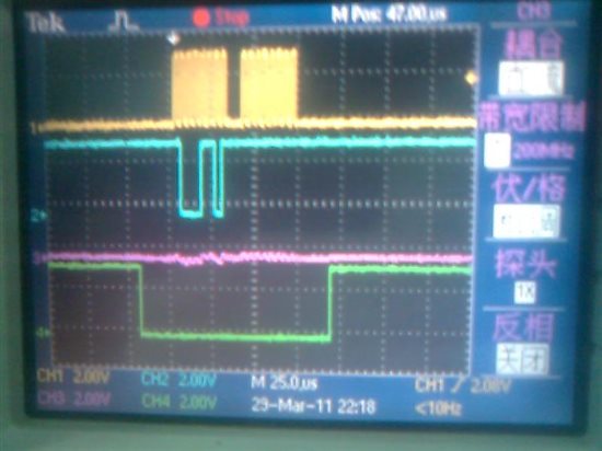

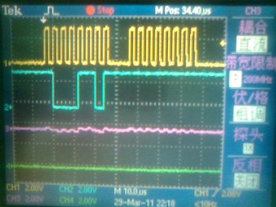

  • 1)  There is only one master and one slave. And in the main function, the initialization of the master is set to SPI. So I wonder whether this can avoid an accidental  IIC condition.
    2)  I set SPICKL to 125kHz and SMCLK is 4MHz .  I add wait functions in the interrupt function and use oscilator to check whether delay is working. Here is the picture I got.
    line 1 :SCLK
    line 2:MOSI
    line 3:MISO
    line 4 : nCS
    I sent command byte 0x8D first and sent dummy byte oxFF on line MOSI.
    Wait function is added right after nCS set low, between the two bytes and after the second byte sent. I wonder whether the wait function works.
     For specific:
    There is only noise on the line MISO. It seems that the slave does not respond at all.
  • Shouldn't the clock be idle-high and active low? It's opposite on your screenshots. It looks like eithe rpolarityor phase are wrong. Looking into the datasheet again, the bit is taken on the rising edge of the signal and has to be stable for some time before and after the rising edge. On teh screenshot, however, it seems that the MOSI signal is changing at the rising edge of the clock signal. Which indicates a wrong polarity or phase setting.
    The noisy line of the SOMI signal, however, almost looks like the slave output is not enabled at all, as if the device were nor there. If the SPI is active, no matter whether soemthign is actually read, it should pull the SOMI line high or low, but not be in tri-state (except in I2C mode, when the internal pullups are disabled). But if it were active, there shouldn't be so much visible crosstalk on the SOMI line.
    Theoretically, when nCS goes low, the pullsp shoudl be activated and SOMI should go high (unless something else is transmitted)
    Are you sure you're applying nCS properly? Is the sensor powered and enabled? Bad soldering?
