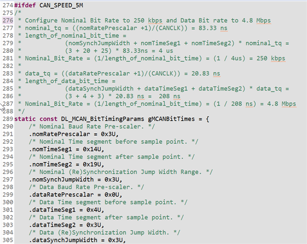

Anyway, the datasheet says that the MCAN peripheral can get to 5Mbps but the SYSCONFIG tool throws an error when I try to get 5Mbps numbers.  The fastest I was able to manually get the transmit to go was this:
static const DL_MCAN_BitTimingParams bitTimes = {
    /* Nominal Baud Rate Pre-scaler. */
    .nomRatePrescalar = 3U,
    /* Nominal Time segment before sample point. */
    .nomTimeSeg1 = 11U,
    /* Nominal Time segment after sample point. */
    .nomTimeSeg2 = 10U,
    /* Nominal (Re)Synchronization Jump Width Range. */
    .nomSynchJumpWidth = 3U,
    /* Data Baud Rate Pre-scaler. */
    .dataRatePrescalar = 0x0U,
    /* Data Time segment before sample point. */
    .dataTimeSeg1 = 6U,
    /* Data Time segment after sample point. */
    .dataTimeSeg2 = 5U,
    /* Data (Re)Synchronization Jump Width. */
    .dataSynchJumpWidth = 0x3U,
This is a 500Kbps header with datarate being 48Mhz/(14)=3.43MHz.  Any faster and the transmit seems to lock up after the header part of the message.
Is there an app note for setting these values?  The SyncJumpWidth doesn't seem to affect the datarate with my limited testing.  I would like to run the MCAN interface at its maximum rate for testing purposes.
