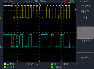

My problem is with I2C, I can send the start signal plus the device address and it seems like the nunchuck sends back an ACK but then the bus becomes "frozen" (for lack of a better term). The microcontroller holds SCL low and the nunchuck holds SDA low.

The following picture shows the bus (SCL is trace 1, SDA is trace 2) with with the nunchuck plugged in:

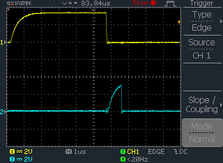

That little spike on the data line concerned me, but it seems to come after the 9th clock pulse so I don't think it's problem, right? Here's a closer look at that pulse:

  • Some guesses in my part. The waveforms look mostly good, start bit, 7 addr bits, w bit. The slave appears to be ACKing the master by pulling down SDA but the slave also appears to be clock stretching by pulling down SCL as well. The slave is suppose to let go of the SCL when it's ready. It just nevers seems to be ready. Google would suggest that the nunchunk only works at 400kHz. You could try 400khz but I'm not sure your pullup resistors are strong enough to pull up the line quickly enough at 400kHz.
  • I thought it was holding the clock low at first, but it's actually the MSP430 that's holding SCL low; the nunchuck is holding SDA low. I say this because when I unplug the nunchuck the clock stays low, and SDA goes high. I've also measured which way the current is going with a multimeter just to confirm what I just described. Weird, eh?

  • In the the case without the nunchunk, there is the extra clock pulse where I assume the master samples the NAK'ed SDA. I would guess that is where the STT bit should clear. Your code would test for NAK'ed error condition and tear everything down with a stop. That should return SCL and SDA back to high. Otherwise, the I2C controller just leaves everything as it left it. One could write a driver that ignores ACK/NAK and blindly transact with a non-existent slave.
    With the nunchunk, I am guessing the master tries to let the SCL return to high in order to sample the ACK but the slave keeps it pulled down. Not familar with the MSP30. Don't know what if does in a clock stretching situation.
