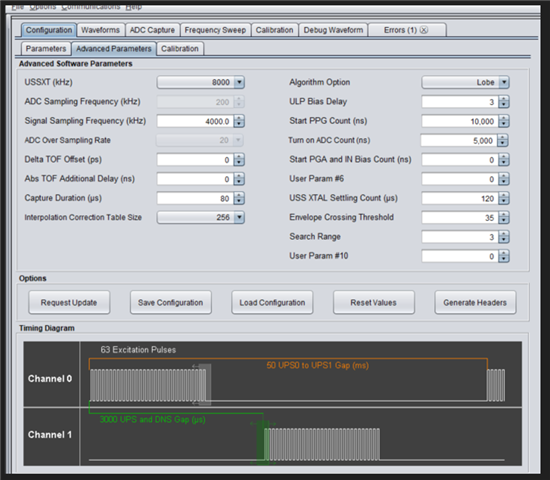

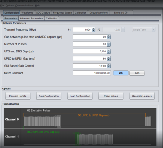

    So for the standard deviation test at zero flow i used the parameters in the below screenshots.
    I increased the number of pulses to as many as possible as i read this was the best way to improve SD, i also increased capture duration to 80. I reduced UPS0 to UPS1 gap to 50 so we would take more frequent measurements.  We do not care about power consumption in our application.
    I increased the GAP between pulse start and ADC capture to 80 in order to make the capture more centered on the plot. Then i adjust the Gain so that the ADC counts are about 900.

    It is just that the number of pulses is quite large and makes the receive signal looks abnormal.
    If you do not care about the power consumption, then I think the current configuration looks good except the GAP between pulse start and ADC capture. You can set it a little shorter incase that the ADC signal moves under flow rate.
