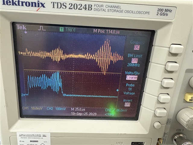

I am using EVM430-FR6043 to set up PUI audio UTR-18225-TT.
Following the quick start guide, the path for image file to load on the chip gives the error below. The path given in quick start guide does not work as well, but i think that is expected, since that is from the date when guide was published? Tried to manually navigate to the image file, but unable to locate one successfully.
To provide context, initial goal is to set up PUI audio UTR-18225-TT transducer. I am attempting to tune the sensor with no flow to start with but only getting noise in ADC capture. Is this due to image on the board?
Referring TI resources including quick start guide, ultrasonic design center, Ultrasonic sensing of gas flow - white paper, design guide: TIDM-02003.
